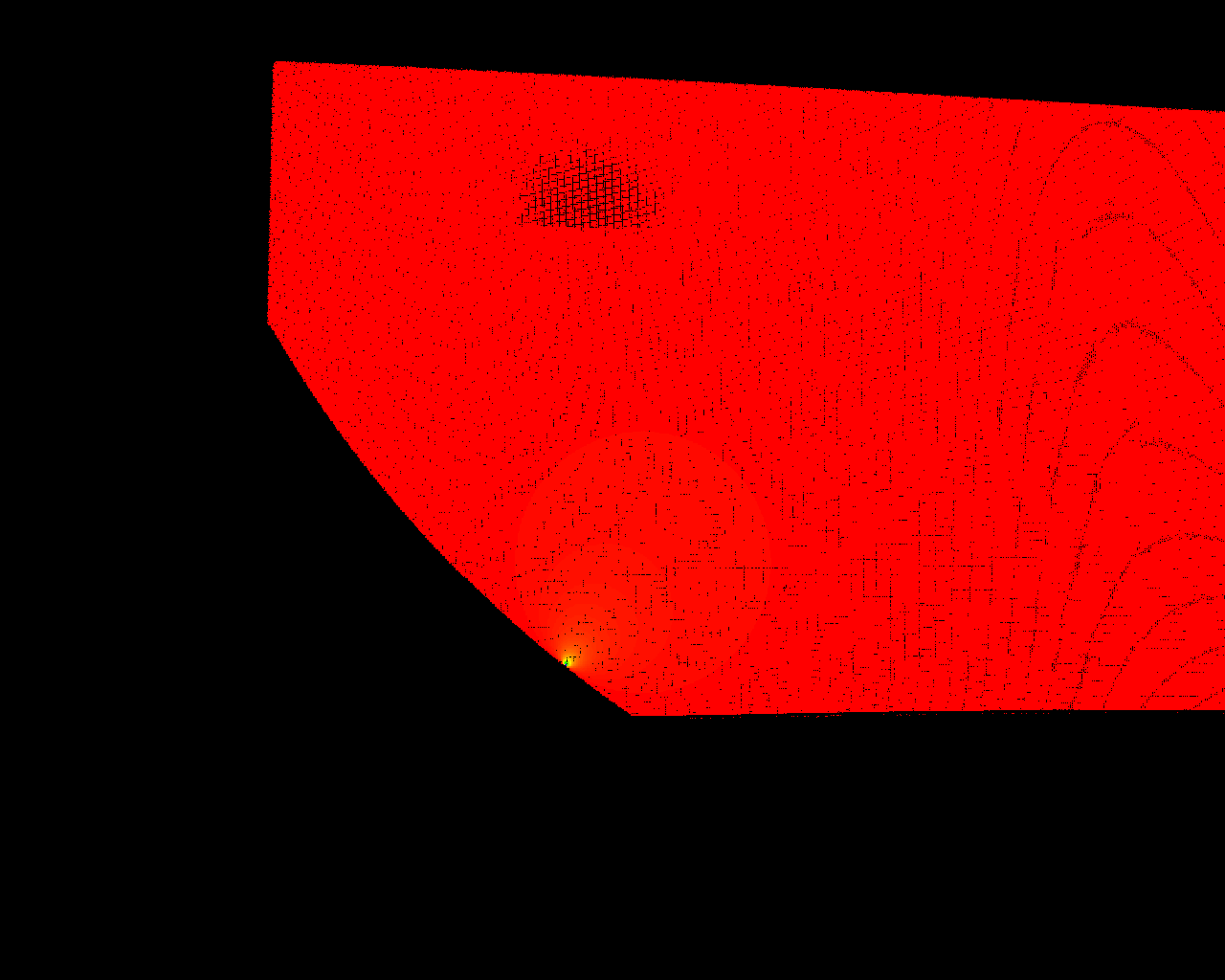

I'm trying to create a point cloud using the software found here: http://www.ti.com/tool/tida-00254
When I scan a flat surface, I get the following depth map:

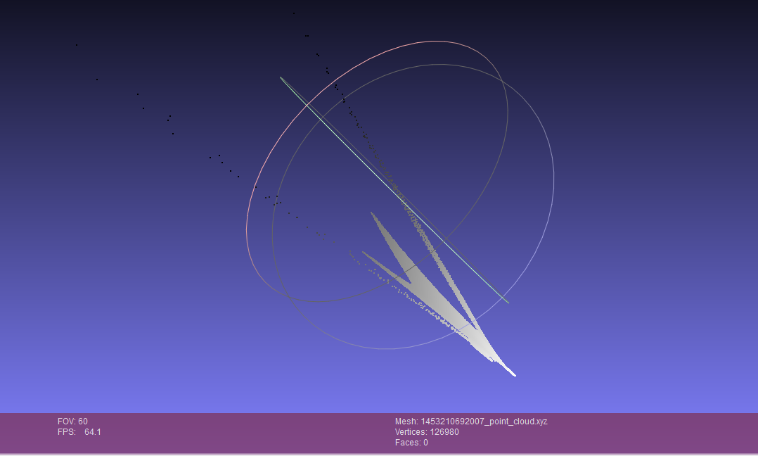

For some reason, it isn't flat. When we view the point cloud in meshlab we get this result:
These are all wrong and I don't know why.
I've calibrated the camera with a reprojection error of 0.300224 and the projector with a repojection error of 1.10386852
Is there a solution to this problem?

  • Hi Sander,
    Based on your projector reprojection error, your system calibration could be the issue. Could you post a photo of your setup? I would like to get an idea of the camera to projector orientation as well as how you are keeping the system locked in place once you complete calibration.
    If you could zip and post your calibration folder, that would be useful as well.
    Clinton
  • If you could include a zip of the output folder (images and point cloud), that would be helpful too.

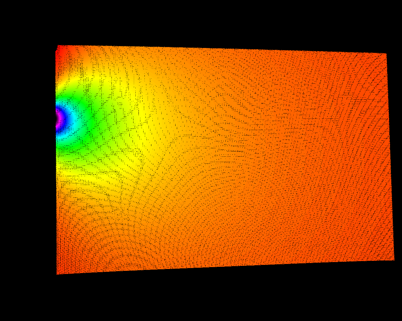

  • I'm still struggling with this problem.
    I recalibrated the system so the camera has a reprojection error of 0.117302 and the projector reprojection error is 0.443832.

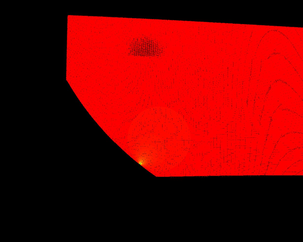

    This is the depth image I get when scanning a flat surface:
    Does anyone have a solution or an idea?
    Sander
  • Hi Sander,
    Thanks for posting your calibration and scan files. I have a few comments:
    1. It looks like you have a glare on your scan surface, which could cause the points to be incorrectly mapped in the point cloud. The original screen shot you posted would be indicative of this. You will want to remove this glare.
    2. Could you follow the calibration process as outlined in the user's guide for the design? It appears you are only moving around a printed calibration pattern around on flat surface, as apposed to:
      1. For camera calibration: moving the camera around
      2. For the projector calibration: moving the calibration board to different angles in the z-direction
    Please see the user's guide for additional details.
    Clinton

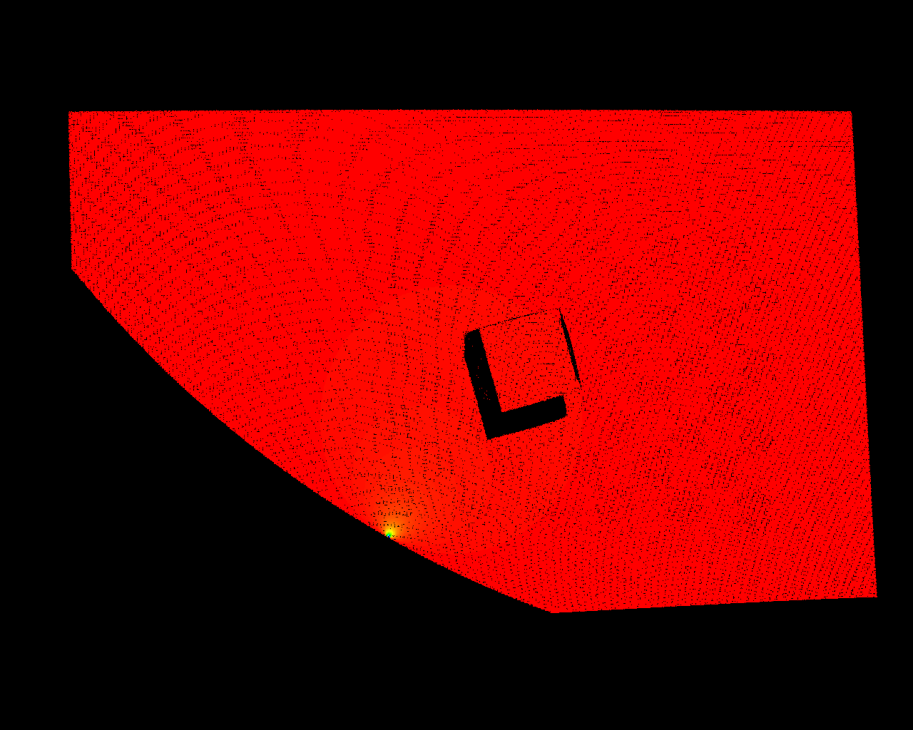

  • Hi Clinton,
    I followed your advise and reduced the glare.
    I also made sure to move the calibration board this time. For the camera calibration I used the option to calibrate the camera alongside the projector (option 5, update camera intrinsic and distortion data).
    My camera reprojection error is 0.15 and my projector reprojection error is 0.44.
    I still get erroneous results, as you can see in the following depth map:
    Here are also all of my output files and my config files.
    www.dropbox.com/.../PC Sander Grielens.zip
    Hope to hear from you soon,
    Sander
  • Hi Sander,
    Thanks for posting your data. A few observations:
    1. It appears for the camera calibration images, you are moving the checker board around.
      1. Leave the checker board stationary at your desired scan distance and unmount the camera
      2. Then hold the camera at various angles to take captures like those found in the user's guide
    2. I cannot tell for sure, but it looks like maybe you are moving the projector around during the system calibration to get the angled shots
      1. It is important that before the system calibration the projector and camera are locked into position and do not move in relation to each other once you start the system calibration
      2. You should not be moving the checker board around the surface, rather you should be moving the surface at different angles, as is shown in the user's guide
    3. The BMP images of your point cloud look very different (have many more points) than your point cloud data (XYZ file).
      1. This seems odd to me
    Please try re-calibrating with the suggestions above. You may also want to ensure there are not any issues with your camera sensor and/or your camera lens.
    Clinton
