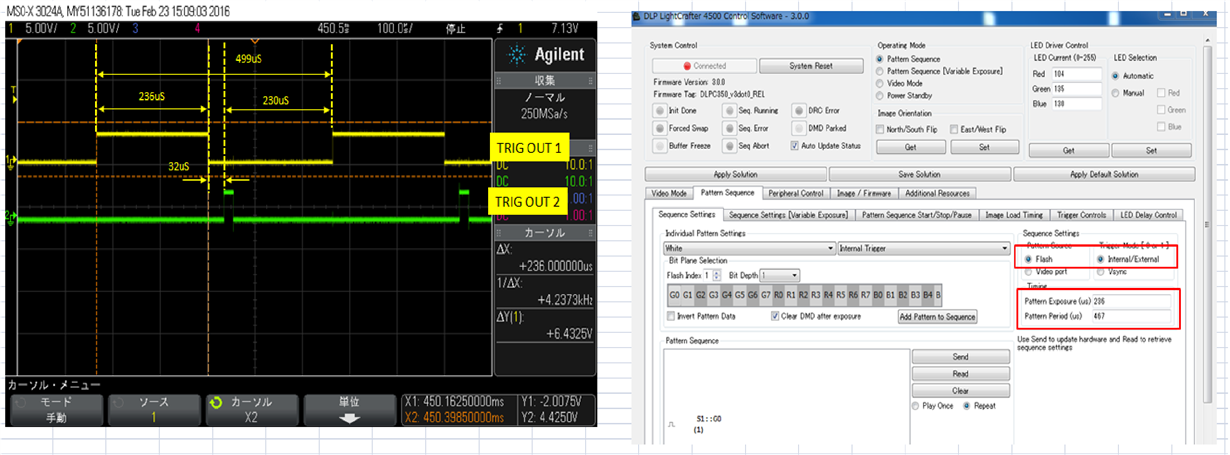

I want to operate with Pattern Sequence mode 1bit pattern.
In the case of 1bit, Pattern Rate is 4225Hz.(DLPU011E Table 4-1. Allowable Pattern Combinations)
Pattern Exposure = 236uS  (4225Hz ≒ 236uS)
Pattern Period =467uS
But it was operated by the above setting,
Period of the waveform was 499uS.
Q1) Why is longer than about setting time 32uS?
Q2) When operating at 1bit Pattern, It is the above setting the fastest settings?

  • Q1) When you apply the settings and play the sequence if you are noticing the Sequence Abort in the status flag; you can either increase the Pattern Period or just keep the Pattern Exposure = Pattern Period.
    Q2) You can set Pattern exposure = Pattern Period = 232 then 'clear' the check box 'Clear DMD after exposure' this will yield the maximum speed.

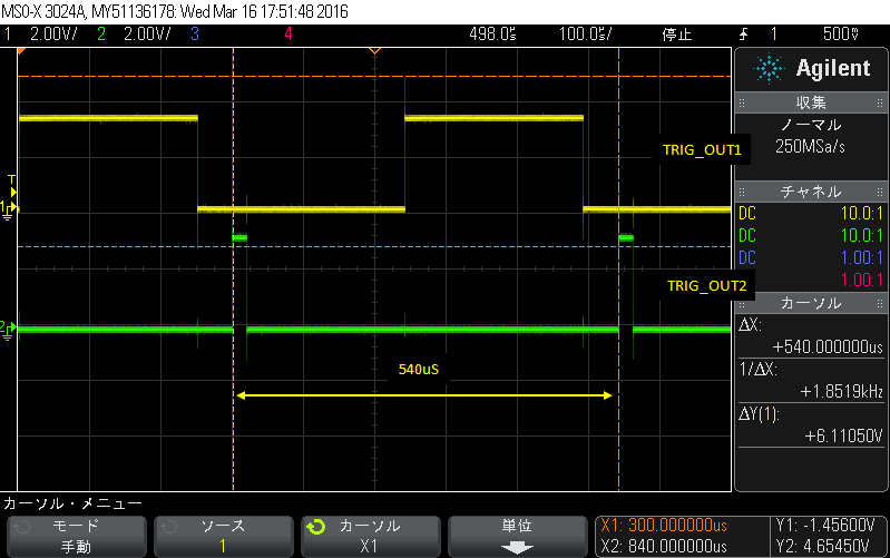

    Let me question additionally, please.
    My customers are the following settings.
     ・Pattern Exposure = 250uS
     ・Pattern Period = 500uS
    The waveform of the case will be below.
    Q3)
    I hope that the Pattern Period is 500uS.
    However, it has become a Pattern Period = 540uS.
    How will it be Pattern Period = 500uS?

  • Hi, Sanjeev.
    Thank you for reply.
    Reply to this slower.
    Rising edge to the next rising edge that is the TRIG_OUT_2 period
    -> 540uS.
    I want to Pattern Period = 500uS.
    How should a GUI be established?

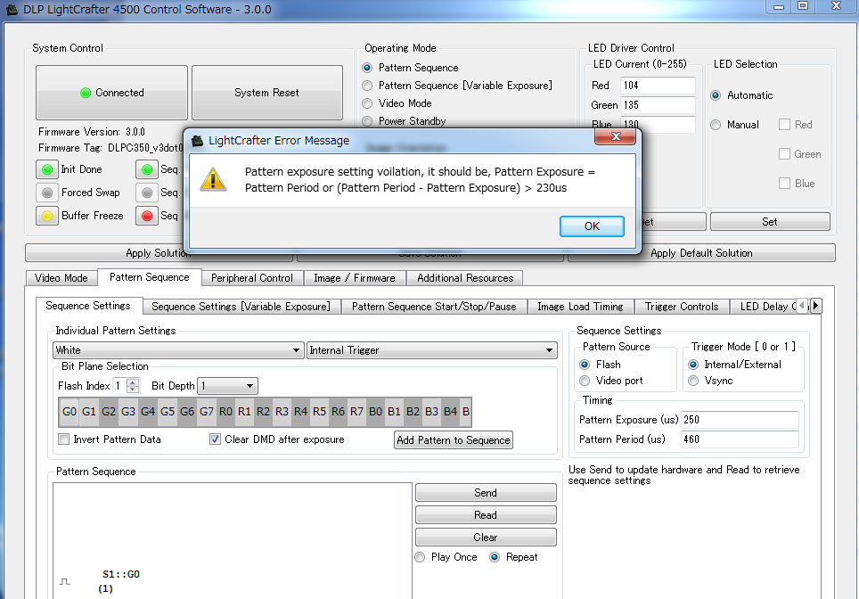

  • Check setting pattern period to 460us instead of 500us, do you get 500us period?
    Sanjeev
  • Hi, Sanjeev.
    It was set to Pattern Period = 460uS.
    In that case, you get an error such as attachments.
    Are there other ways to achieve it?
    Is the specification of the current firmware?
