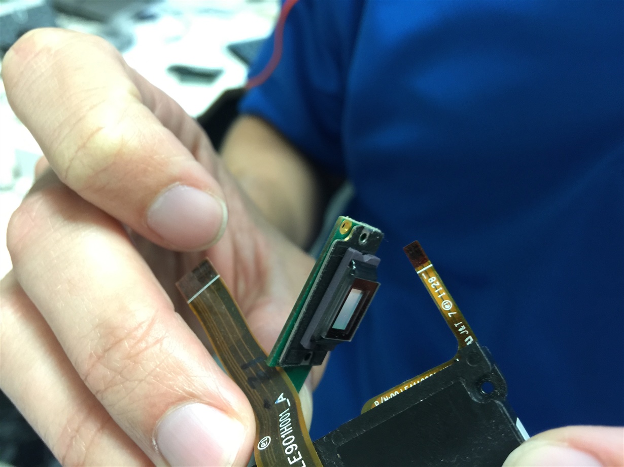

    I have removed the light engine as outlined in this video and am using a custom optical system with a 450nm LED.  After doing this, the test patterns were working as expected.   Again, in both cases, it had worked as expected after I connected the mini HDMI to an external computer for at least a couple of hours.  To be clear, I was unable to properly connect to an external computer because I was unable to match the resolutions, but switching back to Test Patterns worked fine.  After some time, the patterns began flickering.

  • I am using a third party 450nm LED to illuminate the DMD. This setup worked well for two separate LightCrafter EVMs with Light Engine removed, but after some time I started seeing the issue that I described in my first post and is shown in the video of my first post.
  • Melissa,

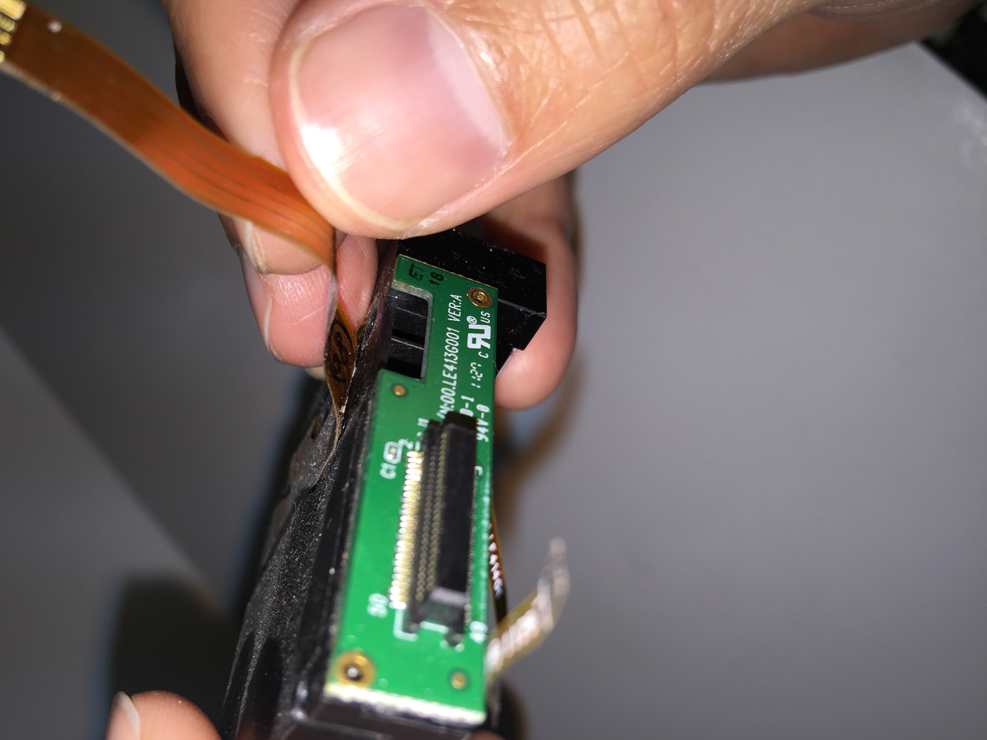

    Yes, it makes sense to run this test with the DMD into the light engine.  The  "triangular notch" point as shown on the attached pictures.

    As for my customized system: I removed the optical system as outlined in the TI video and blog posts, I also flipped the systems and drivers board 180˚ as they mentioned at the end of the video. I connect the LightCrafter to the PC through the mini USB port and control it through the GUI. I am able to connect the device through the GUI successfully. Then I choose, for instance, the fine checkerboard pattern.

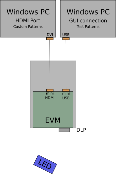

    Could you also show a diagram of how your illumination is wired up and how your solution is set up to generate your patterns in the software.
    Thank you,
    Fizix
  • Hello Mellisa,
    Thank you for the diagram. In discussing this here we realized that we have not asked how much optical power this LED is illuminating the DMD with and what wavelength(s). Could you tell us about the LED characteristics and how much current you are driving it with?
