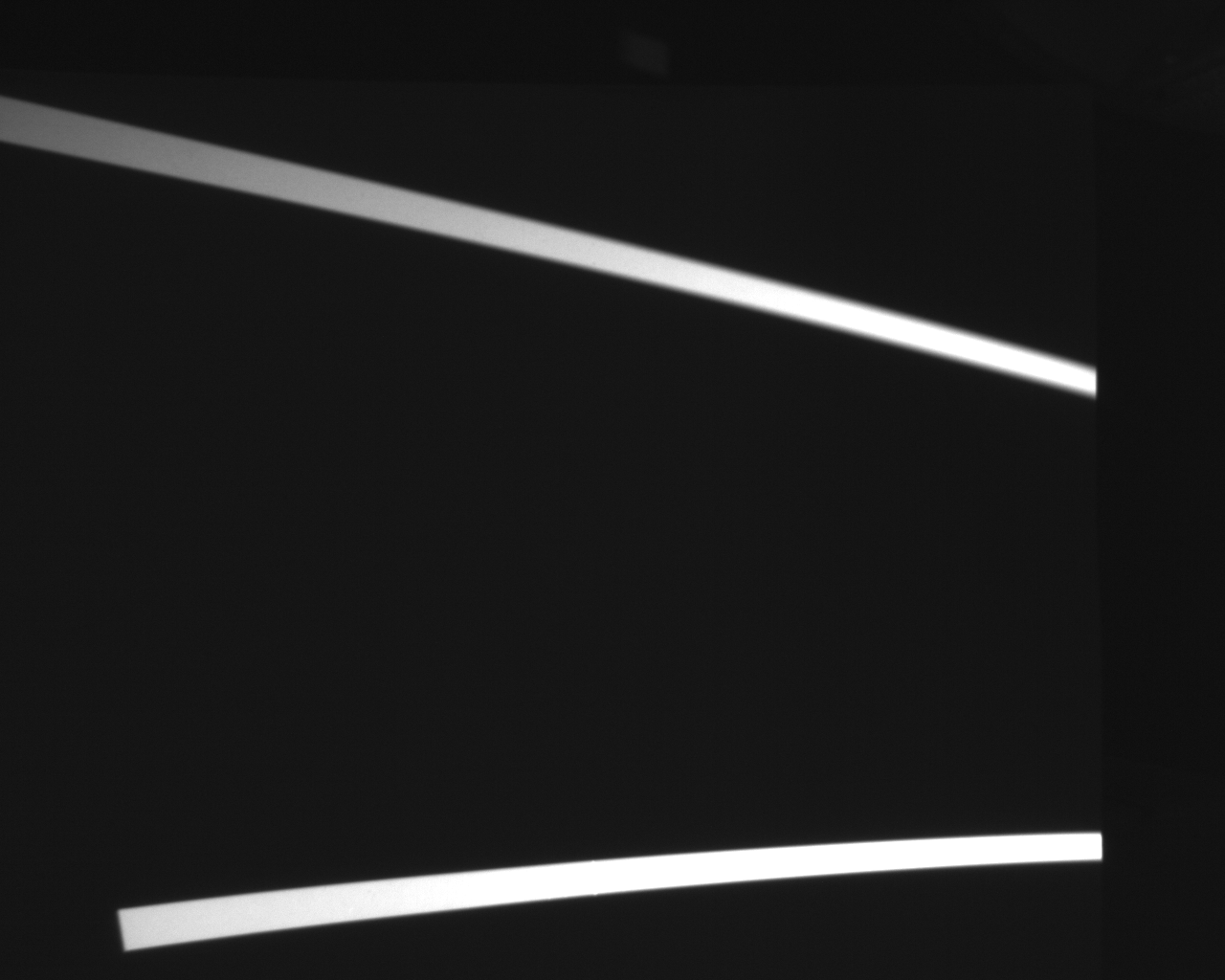

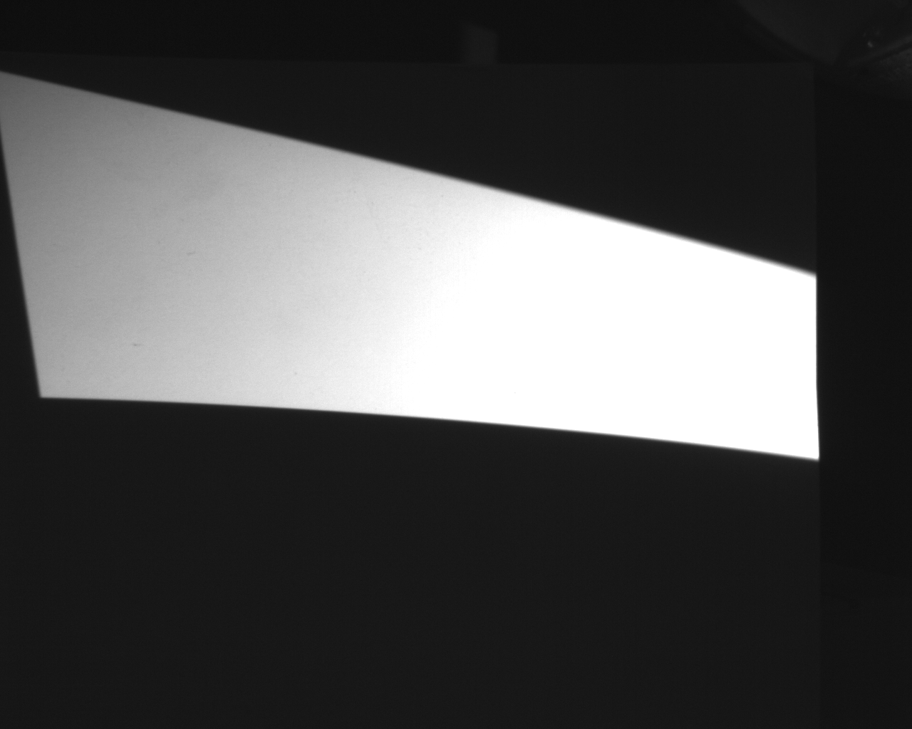

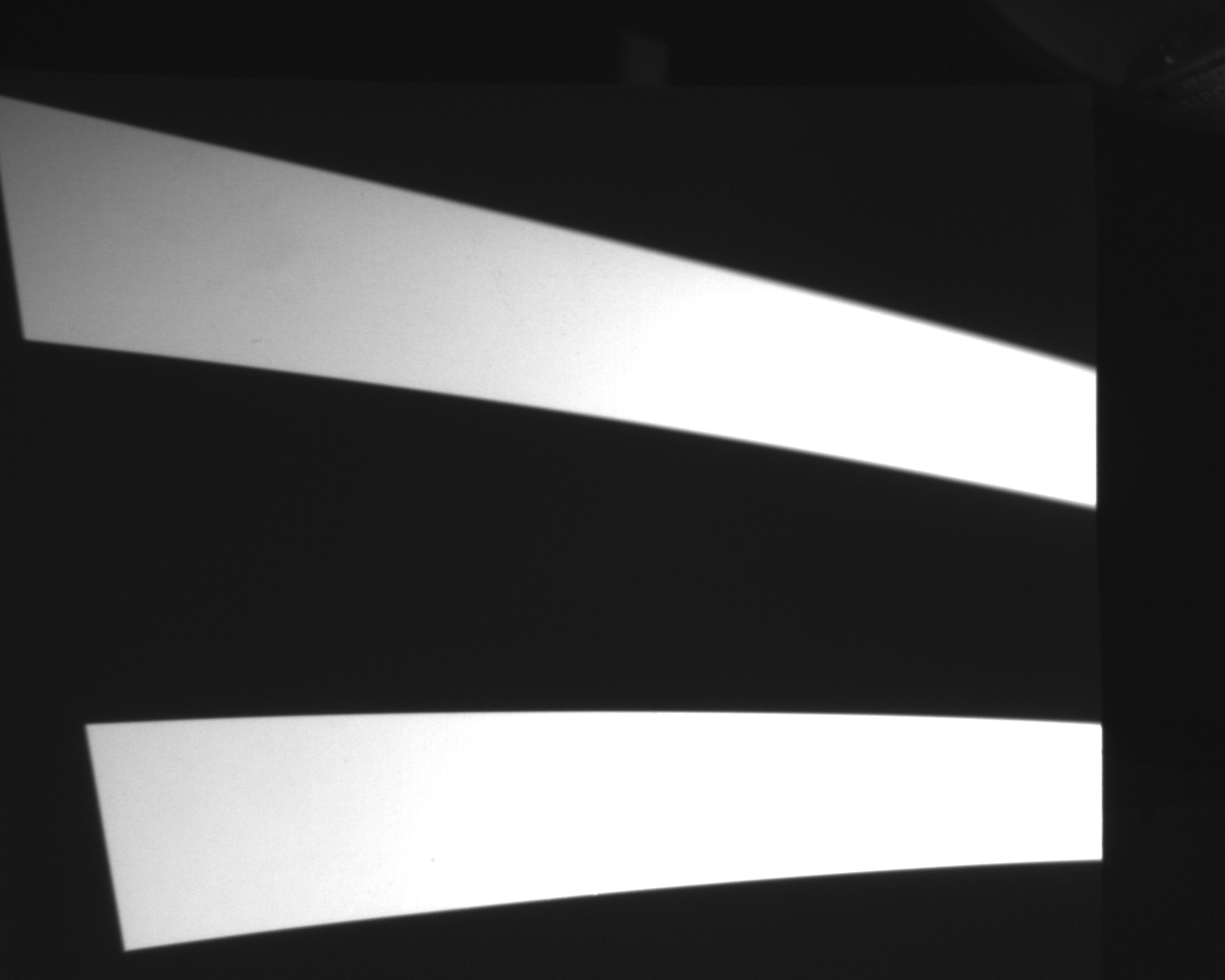

I am having a problem with the display of the horizontal illuminations. If I dump them out from the part of code that is generating them they look fine, but the images that are actually rendered are messed up.
The first few are correct:

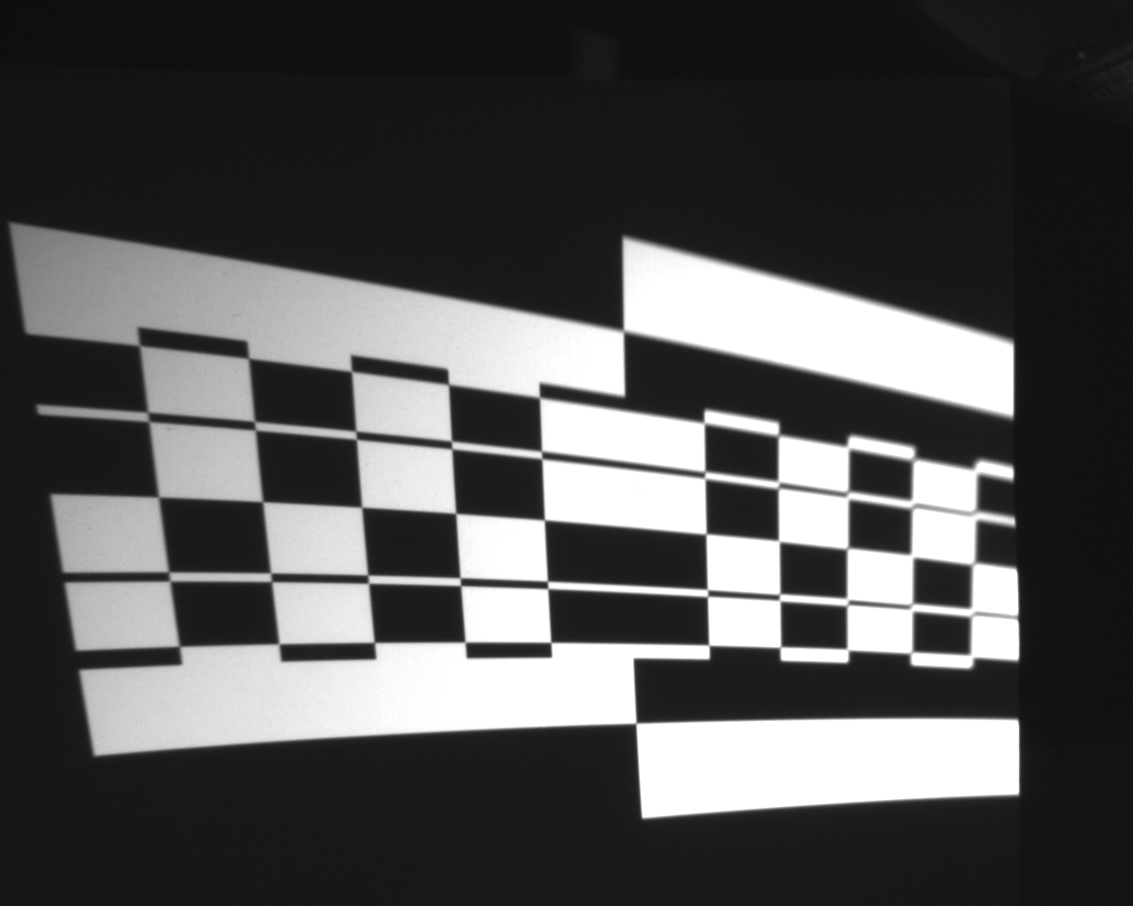

But then things get screwed up:
(and the rest of the following horizontal images are screwed up too).
Any ideas? Perhaps the firmware download is stopping partway? I am not getting any errors...

  • Andrew,
    You can perhaps save them on the PC; then use the LightCrafter 4500 GUI to upload the pattern and display them. If this is working properly then you can narrow down to your code where you are configuring the hardware.

  • Update:
    I tried changing the patterns in the source code and flashed them. Again, the first projected patterns were more or less what I expected, but the later ones were corrupted.
    So  I believe the flashing of the images is not completing in my linux build.
    I haven't had time to track down that problem, but I was able to re-flash the board using the windows build from TI, and then take scans using my linux build.
