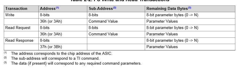

I'm working on the DLP Lightcrafter 4710 and I want to control the display resolution via I2C commands.
To do that, I send I2C commands via a terminal
i2cset -Y 1 0x1B subaddress value
So I can control a lot of parameters but when I tried to set the screen resolution, but to do so I have to send multiple bytes and I don't know how to do this via the terminal.
Anyone have some clues on how to do this?
