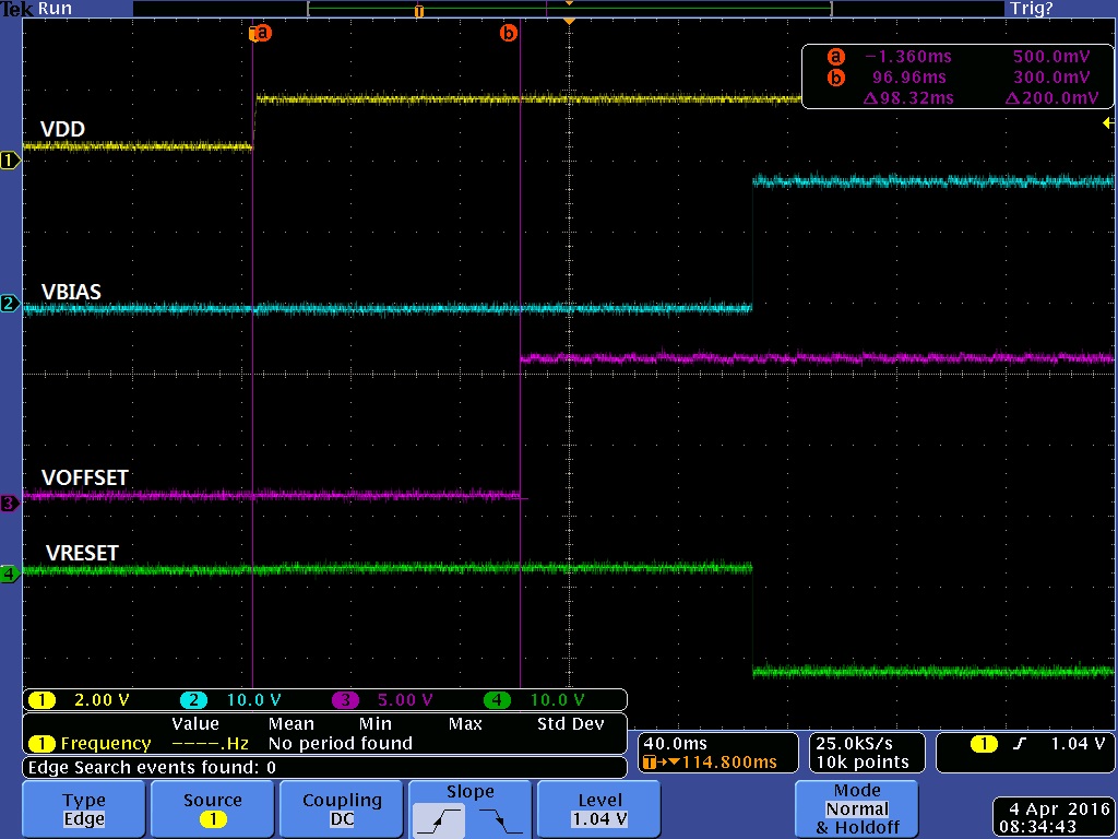

I expect that State of DLPA3000 is ACTIVE1. because voltage level and sequence of VRST,  VBIAS and VOFS is normally.
VRST = -14.25V
VBIAS = 17.58V
VOFS = 9.82V
[Sequence]
What should the state of DLPA3000 wonder whether the ACTIVE2.

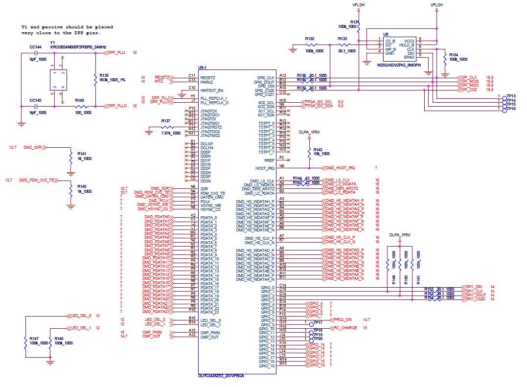

    I would like to take a look at your schematic to ensure that everything is correct on the hardware side.
    Can you please let me know what the desired LED current and the Input voltage of the DLPA3000 is ?
    Is VDD the input voltage to the DLPA3000 ?
    It would be helpful if you could provide the schematic of your board and the used software version.

    A2) No. VDD is DLPA_1P8V [PWR2]. Previous jped file is Input voltage of DLP3010.

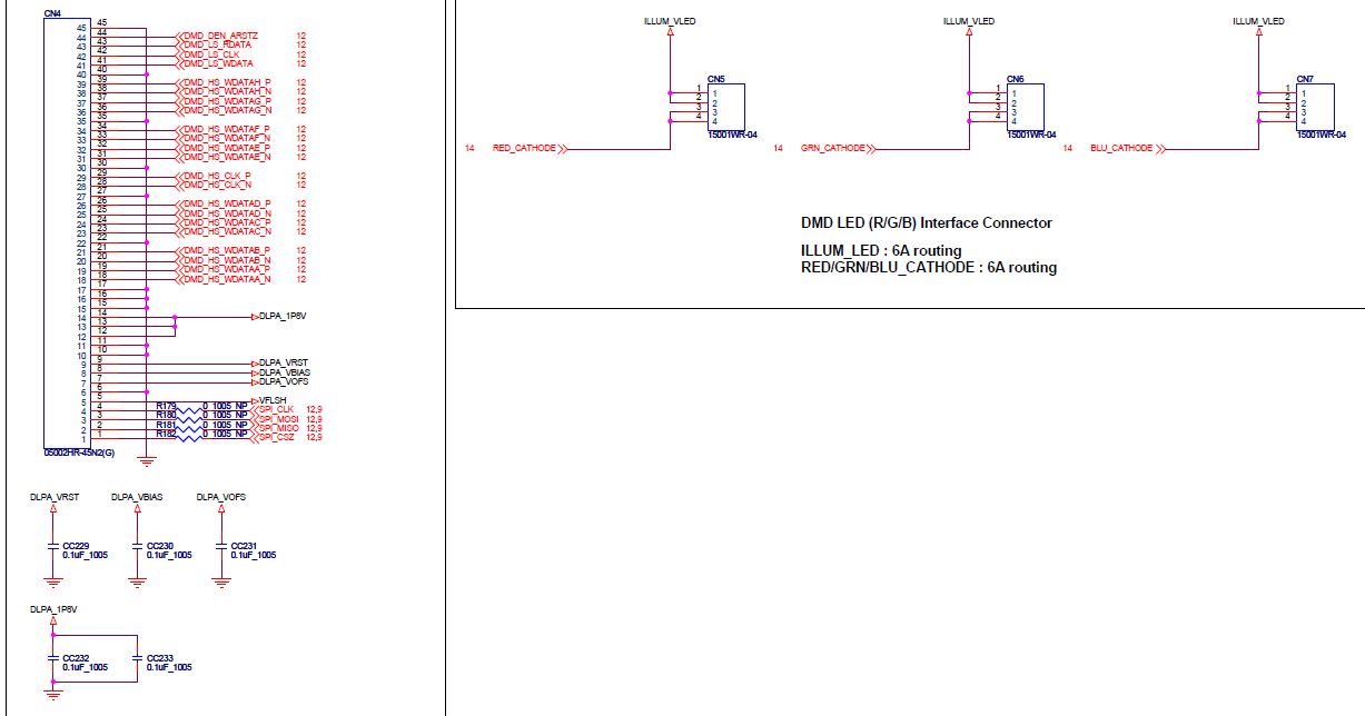

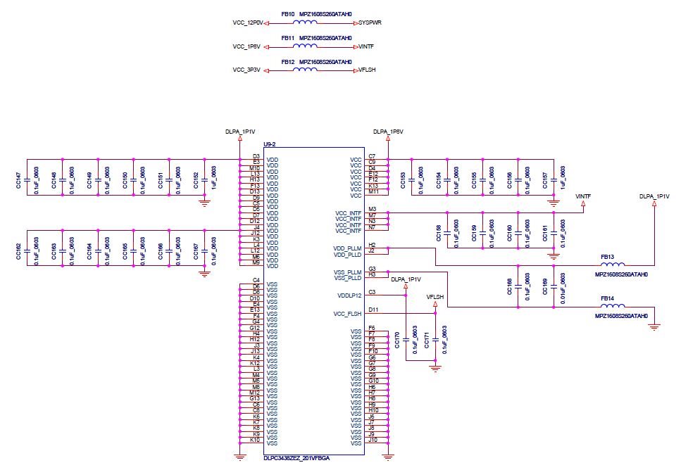

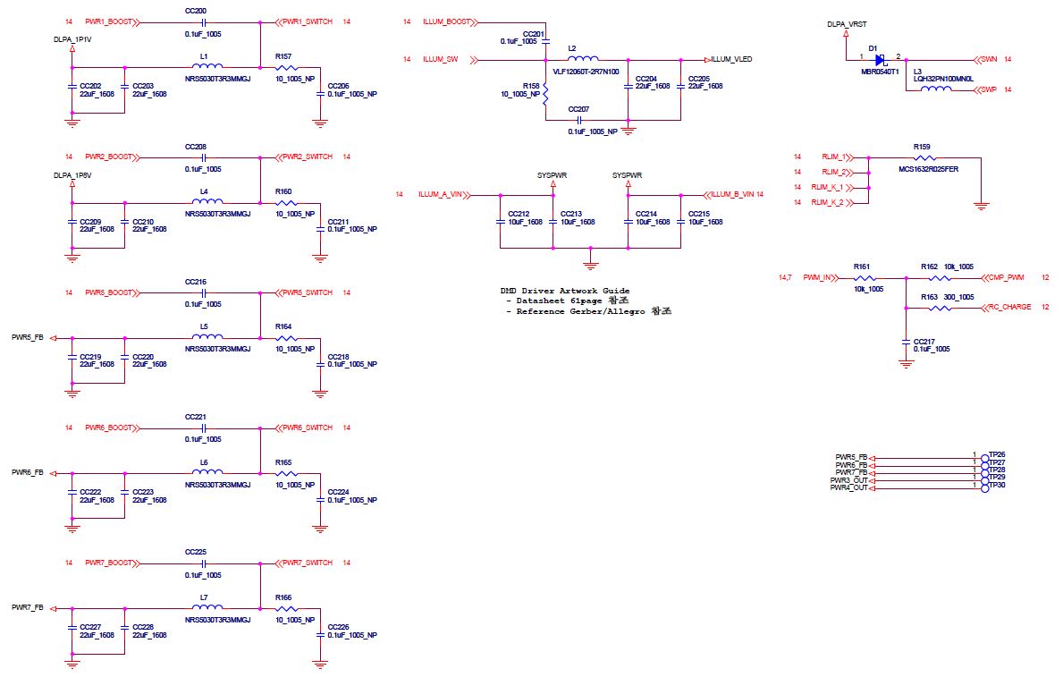

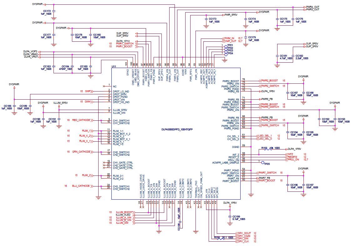

    Below it is requested schematic file.

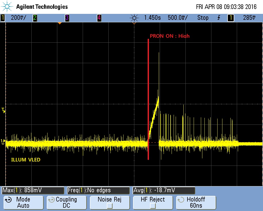

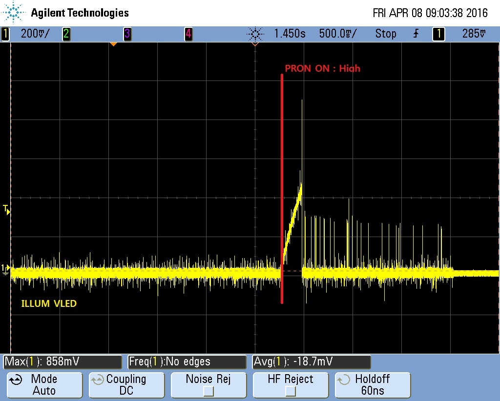

    There are currently schematic ACMPR associated circuit remains a Test point. We are referring to a circuit TI LightCrafter Display 3010 separately but still VLED is not operated.

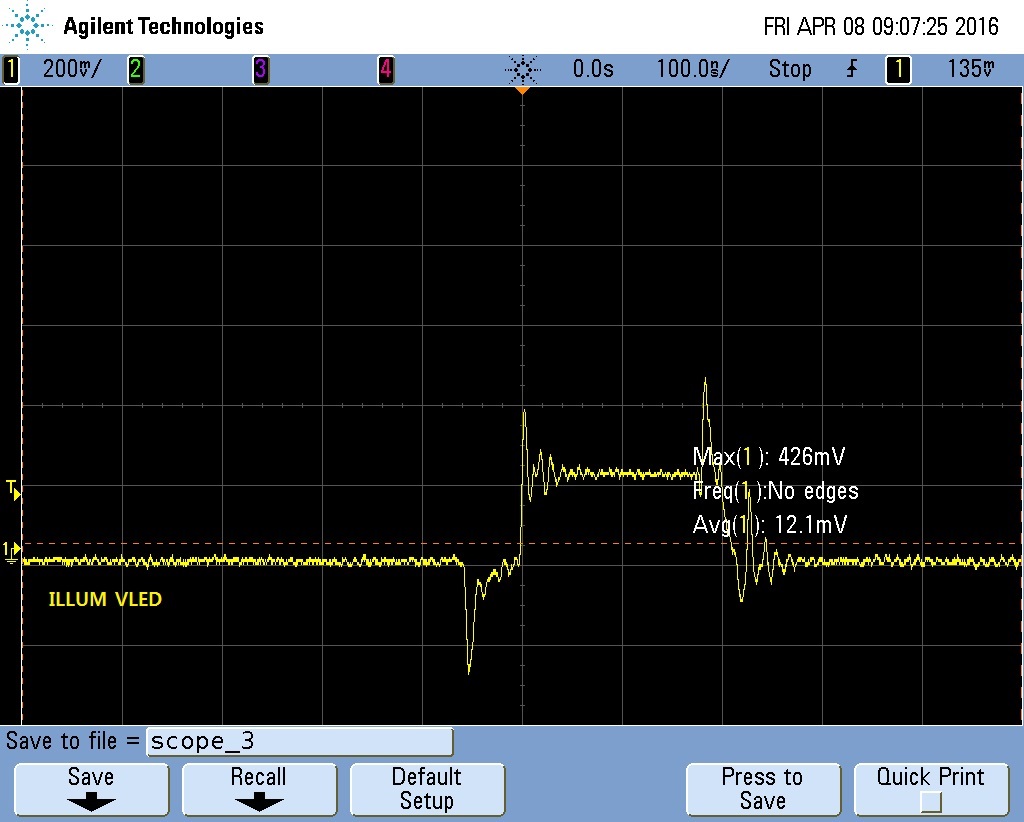

    Below is a waveform measured VLED.

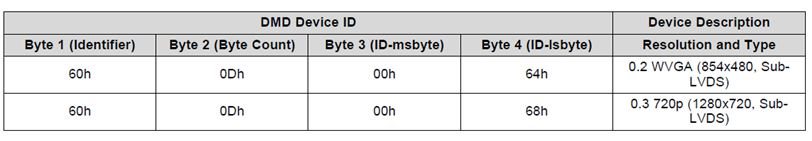

    Q) When read DMD Device ID(D5h), we get data [60 0D 00 72]. below DMD Device ID is [60 0D 00 68].

  • Hello User,
    Thank you please allow me some time to review your schematic. In the meantime can you please send me scope plot which shows VLED and VIN ?
    Can you also please try to reduce the LED current during power up and let me know if the behavior is changing ?
    What value are you using for the RLIM resistor ?
    Also please note that currently PWR5 and PWR7 are not supported. Do you have anything connected to them ?
    We changed the DMD device ID to 72h. Your reading is correct.

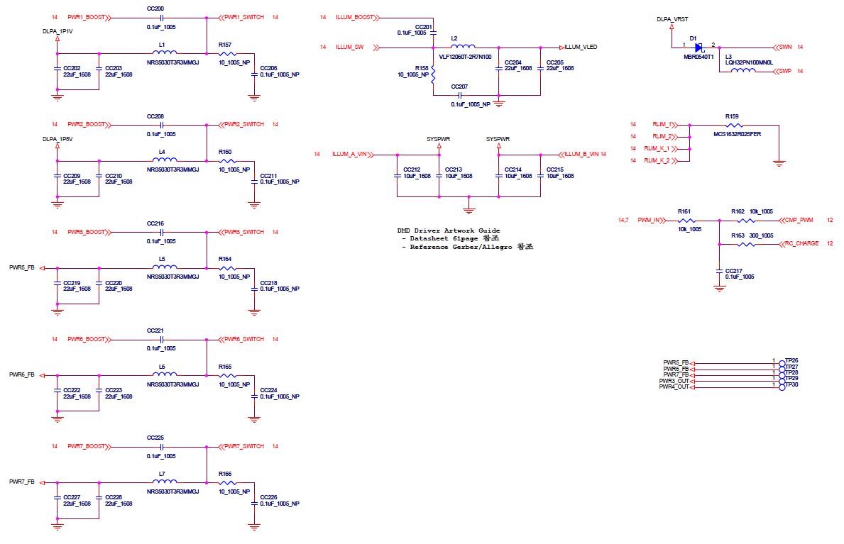

  • Hello User,
    I looked over you schematic and it looks good. Since I only see the schematic I want to point out that the RLIM_BOT_K should be connected to the bottom of the RLIM resistor.
    What firmware are you using on your system ?
    Nadine
  • Thanks for your reply.
    I have solved this problem.
    Value of RLIM resistor is 25m[Ohms].
    Problem is warning of Schematic [ILLUM_A_VIN, ILLUM_B_IN].
    ILLUM_A_VIN and SYSPWR art not connected.
    Once again thanks for your reply.
    Best regards.
    Kim ki-heon
  • Hello Kim,
    Ok great. I am glad the problem could be solved.
    It looks connected in the screenshot you have send me.
