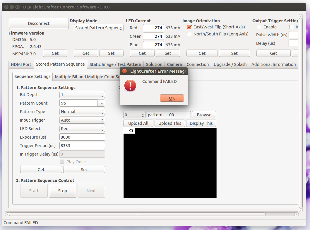

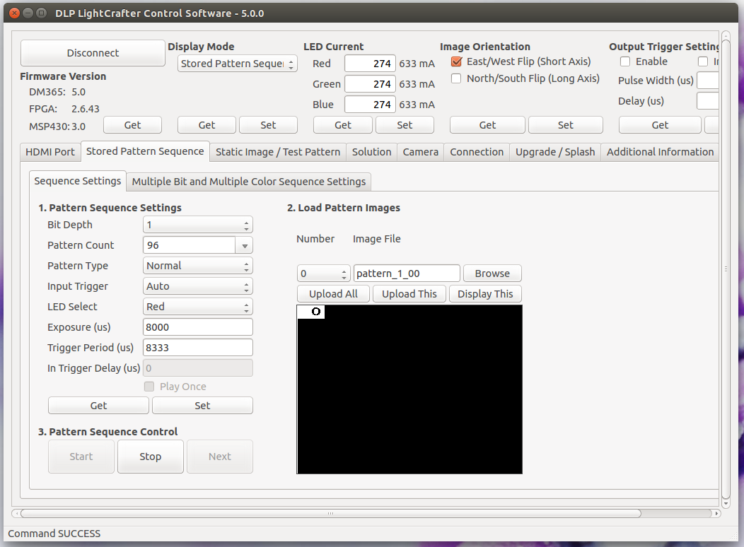

I am able to display a static image, but when I try to display pattern sequences, after I click on Start, I get command success but nothing is displayed.
While if I click on Display this, I get command failed:
These are the steps that I follow:
  • Set Display Mode to Stored pattern Sequence
  • Set Bit Depth to 1
  • Pattern Count 96
  • Pattern Type Normal
  • Input Trigger to Auto
  • LED Select to Red
  • Set exposure to 8000 us
  • Set trigger period to 8333us
  • Click Set on the sequence settings
  • On the Load Pattern Images tab, Browse the images
  • Upload All
  • Start the sequence
Any ideas of why this is happening and how I could solve this?
