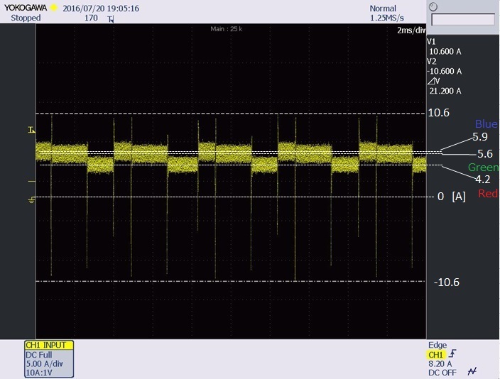

I designed projector(DLP3010+DLPC3438+DLPA3000) and measured DLPA3000 VLED(ANODE) current as shown below.
LED current parameters are R:700(4.5A)/G:1023(6A)/B:1023(6A).
Why are actual currents different between Green and Blue?
Thanks.
Hello User,
I would need more information about your system to be able to address your question.
What RLIM value are you using on your design ? What firmware version are you using ?
Nadine
