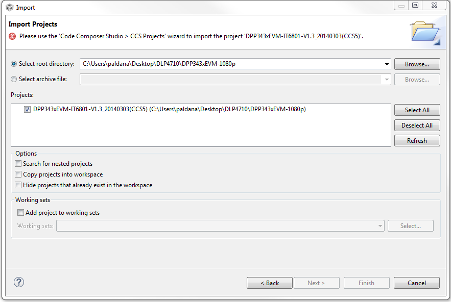

    Regarding the sample source code, I did download CCS v6.1.3 and tried opening the existing project in the zip file I downloaded. It gave me these errors:
    This is through the File>Import..>General>Existing Projects into Workspace :
    This one is through the  File>Import..>Code Composer Studio>CCS Projects :
    The error states: "
    See details below.
    Error: Import failed for project 'DPP343xEVM-IT6801-V1.3_20140303(CCS5)' because its compiler definition is not available. The project does not appear to be a 'CCS Project'. Please try importing it through the 'General > Existing Projects into Workspace' wizard."
    Do you have any idea how to go around with this?

  • Hello Paul,
    I tried to recreate the issue with Code Composer v6.3.1 and I was not able to see this issue.
    You might want to try to re-install Code composer.
    With the MSP430 you can only send I2C commands to the DLPC3439. The supported I2C commands are listed in our Software's Programmers Guide.

  • Hello Paul,
    Yes I meant v6.1.3 unfortunately I don't see the error message you are seeing.
    I would try to reinstall code composer and you might try an older version too.
    I did a quick research online and I found someone had a similiar problem using CCS5 with a CCS4 project. He renamed the project and the problem was gone.
    This would be something you might want to try.
    See below the description and link:
    e2e.ti.com/.../185063
    Hi all, I was able to fix this by changing the project name in the .project of the project you're trying to import. On line 3 you'll find the project name, add something to the end like "ImportTest".
    <?xml version="1.0" encoding="UTF-8"?>
    <projectDescription>
    <name>MyProject.ImportTest</name>
    The error about the compiler not found/installed went away, and I was able to import.
    It's odd how a project name conflict can result in an error insisting about not finding the compiler..
    Nadine
