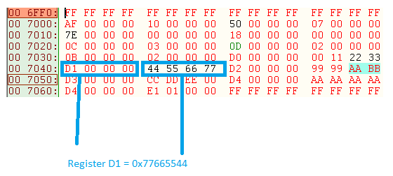

    I also searched for some of the byte patterns in the config file that I downloaded from the DLPC300 page (DLPR300PROM_v1.0.bin). The attached image shows what I believe is the default value for register D1.

  • Yes, but that's not the only one. 0xD1 also has a different value.
    I searched for the value and found the following sequence at address 0x007040: D1 00 00 00 44 55 66 77
    This confirms that the register value did indeed came from the config file.

    0xD1 has a different value because the DM365 writes to that register on startup.
