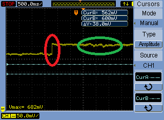

    How are you measuring the fluctuation? Are you able to determine how often the fluctuation is occurring? Can you provide scope shots or data?
    Paul

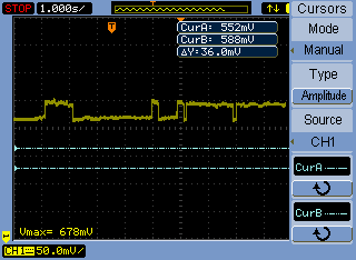

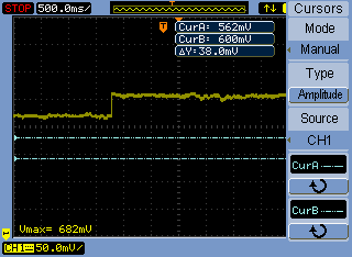

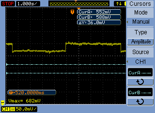

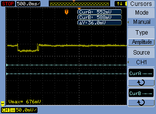

  • Paul,

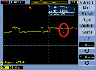

    To measure the fluctuation, I have placed a photodiode in front of the DMD, in the direction of the reflected beam (the one reflected by the on-state mirrors, in our case, black pixels). I see the photodiode's readings in an oscilloscope.
    I have set 10 images with the same pattern: every mirror is in the same on-state (the equivalent to 'Solid Black' in 'test pattern' mode) in "Stored Pattern Sequence", with an exposure time of 1s and a trigger period of 1001000 us.
    I have attached four images taken with the oscilloscope. In each of them, the variation in the signal is a bit more of a 5 percent of the original amplitude. I have not been able to determine how often this fluctuation occurs: sometimes we have a stable signal for a long time (of the order of 10s) but still this time is never constant.
    Inigo
  • Inigo,
    Thanks for the scope shots. Just to make sure I'm understanding correctly, are you concerned about the fluctuations in the red circle (big steps) or the small fluctuations in the green circle?
    Or, if it's neither of those because the red circle (big step) is simply a state transition of the mirrors and the green circle (small fluctuations) are noise in the photodiode, then is it the behavior shown circled in the next image that is the concern?
    Thanks for the clarification,
    Paul
  • Paul,
    We are worried about the big steps.
    We expected the intensity to be constant during the exposure time, but in the shots you can see that these transitions change the intensity to a new constant value that extends for too long (recall that our exposure time is of 1s, while the time extension of this states is of 2-3 s).
    The red circle in the bottom image is also a problem, in the sense that we would like to know the times at which these transitions appear.
    Also, do you know what these state transitions are? Because we are loading the same images, I would expect the intensity not to change or only change during a short time between each picture (that is: after the exposure time, I would see a variation in the intensity for a short time).

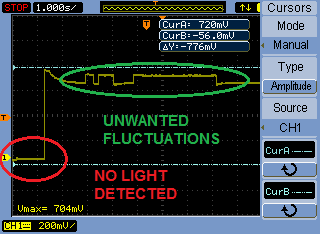

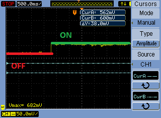

    I'm sorry, but I guess I'm still not quite following. In the picture below I've labeled OFF and ON states, but I think I'm actually incorrect. The OFF state should much further down the screen in your shot if I'm reading your scope screen correctly. You have a max value of 682mV and 50mV per division.
    The part is confusing me is the time scale - it's set to 500ms per division. If your exposure is set to 1s, then why don't we see a large transition between 0mV and 682mV for a mirror state change?
    Can you clarify what you mean by the above? You're not seeing behavior that reflects the desired exposure settings? This to me makes me wonder about your experimental setup. Are you capturing on your photodiode a large enough block of pixels that changes from ON to OFF such that the whole diode is covered? Your pattern could be turning only a portion of the pixels that the photodiode is measuring, causing your intensity to bump up.
    Setting the patterns to an exposure of 1 second is long enough the eye can differentiate between the patterns. As you watch the patterns change does it seem like they are switching correctly and with the right exposure? If it looks like they are, I would again suggest that perhaps there is something going on with the measurement setup.
    Some general information that might apply here: The pixels need a few 10s of microseconds to settle out between the transition of ON to OFF. In that time, you might see some slight variation in intensity between the patterns as the mirror bounces a little. However, on your timescale, it is unlikely that you'd see that behavior. Even in the case where the pixel doesn't change state between patterns there will be slight movement of the mirror, but it's typically only a few degrees.
    The Lightcrafter has been released in the field for about 4 years, we haven't seen any issues like this arise with the EVM itself. Can you confirm that you're using the latest version of the software and the firmware on your device?

  • Hi Paul,
    I think I did not make myself clear:
    Those states are not ON/OFF states. The only pattern I am loading into the DMD is a completely black image. Since, in our setup, black pixels correspond to reflected light, during the exposure time (1s) the DMD should be reflecting all the incident light into the photodiode (thus recording a high intensity).
    The low intensity level that you see in the shots does not correspond to zero detected light: It is precisely what we don't understand.
    I am attaching a scope shot I just took: I blocked the laser beam so that no light would reach the photodiode, and then I let the light arrive again. In the shot, you can see the time at which all the light is blocked (red) and the time at which it is detected again (green). As  you can observe, the fluctuations are there (5% in amplitude).
    (I chose the time scale to 1s because it was of the order of the exposure time and because we could see this weird state... Also, the voltage scale and the offset were completely arbitrary.)
    The reflected light is such that the whole photodiode is covered, so that should not be a problem.
    When I load different images (say, one completely black followed by a completely white picture), I can see by eye that the device is changing them in the correct time.

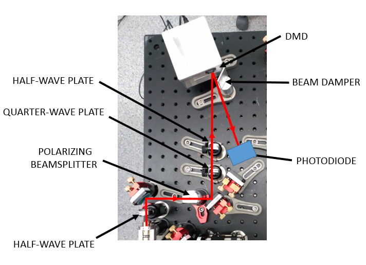

  • Hi Paul,
    I found TP35 in the Driver Board schematics, but it seems that it is not labeled in our physical board. Because of this, I cannot find TP35 in our driver board (I found boxes U13 and U14, and even capacitors C57, C62, ... but TP35 is nowhere to be found). Is there any document with the names and locations of the pins on the boards? If we could have access to such a document, it would be extremely useful for future electronic problems. If not, could you indicate me where to find TP35?
    I send you a picture of our optical setup with a brief explanation that might help understand it better:
    I have a 5mW laser (780nm wavelenght) that is first coupled into a fiber (this is not in the picture). In the picture, in RED I show the path of the laser beam after it comes out of the fiber.
    I use a half-wave plate to change the polarization of the beam, and a polarizing beamsplitter that makes sure that only linearly polarized light passes through. This way, all the light that comes out of the beamsplitter is now linearly polarized.
    For our experiment, we want the light reflected by the DMD to be linear. Placing a quarter-wave plate and a half-wave plate before the DMD allows us to change the polarization of the linear light to any other polarization. We tune the plates in a way such that the beam coming out of the DMD is linearly polarized.
    The reflected light goes into a photodiode, which I have painted in blue.
    As you can see, the LightCrafter is mounted on a homemade box, to which the board is screwed. I have noticed that the connection of the DMD to the board is not very static in the mechanical sense (with this I mean that the DMD can move by simply touching its sides, as you can verify in your own LightCrafter). Maybe the fact that the DMD is not very static causes the beam to 'move' (i.e. to be reflected in a different direction) at certain times, and the photodiode does not catch as much light as before, causing a fluctuation. In fact, placing a CCD camera in front of the DMD, it looks as if the position of the beam moved at random times...
    Inigo
  • Paul,
    I just noticed I did not mention the beam damper in the explanation above: The light reflected by the 'OFF-state' and 'flat-state' mirrors goes to the beam damper, which simply blocks it.

  • Hi Inigo,
    Thanks for clarifying your setup. Let me look into how to access/open the layout files. They are included in the link I gave above, but I'm having trouble getting them open myself.
    The only thought I have on why those fluctuations might be occurring after seeing your setup is related to your comment about the DMD not being very static. Could vibrations in the lab be causing the photodiode to pick up some light that was intended for the damper?
    Paul
