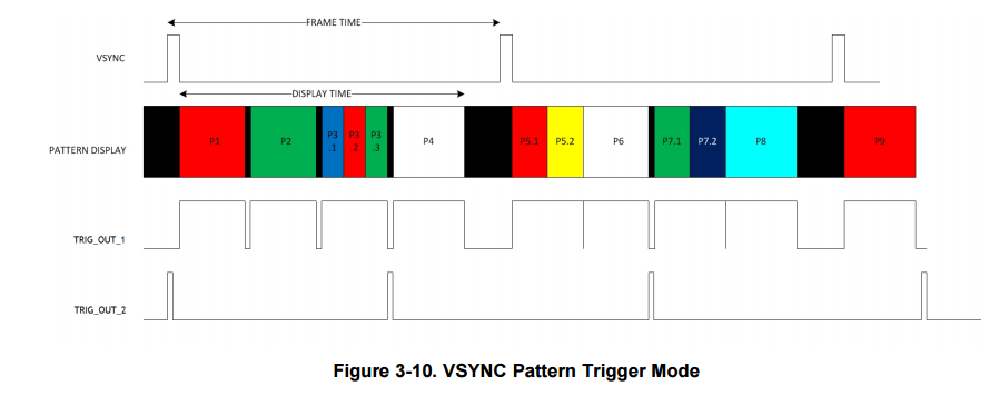

    The way you are trying to use the pattern sequence mode to stream over HDMI is not in the recommended use case. The suggested application is to have pattern exposure times less than the VSYNC to VSYNC timing (typically 60Hz) from the HDMI. This ensures no data is changed while the selected pattern is being displayed. In the user’s guide “Figure 3-10. VSYNC Pattern Trigger Mode” shows that the first VSYNC signal coming from the HDMI source will start the pattern sequence. To clarify the user’s guide, the VSYNC signal does not act like a trigger to display the next pattern; it is a signal to notify the arrival of new data. The exposure time for each pattern can be controlled through the GUI under the ‘pattern sequence’ -> ‘sequence settings [variable exposure]’ tab, as described in section 3.3.1 of the user’s guide.

    Sorry about the hiatus. I have got some more information in the mean time on how the  video mode can be used in the type of application you are describing. The device transmitting the image data will need to know when the pattern exposure is complete. There are two output triggers from the EVM that can be utilized. These triggers would be used to notify the device transmitting the image data to move to the next image. It should be noted that the image will not change until the next VSYNC signal is received by the EVM. More information on the output trigger can be found in section "3.3.4 Trigger Controls".
