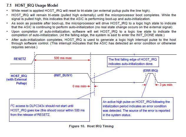

Dear Sir:
       I have read the Programmer's Guide, but I didn't find how to read the register of HOST_IRQ.. Which register corresponds to the HOST_IRQ ?
       There are some related documents describing it ?
                                                                                                                                                               Thanks For You Help
  • Hello User,
    Thank you for your interest in our DLP Technology.
    Host_IRQ is an output on our DLPC3433 (please refer to the DLPC3433 datasheet). The Host_IRQ signal can be measured or can be used as an input to a processor for further monitoring.
