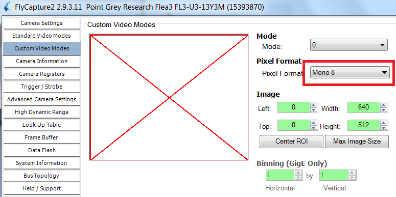

  • Hi Josh,
    Can you set the camera up to be in mono8 mode? Use the FlyCap2 software to do this. You'll find it in the settings window where I have indicated below:
    Once you've done that, try re-running the TI design again and see if there error goes away.
    Paul
  • Yeah I went to change it to mono8, but it actually already is in mono8 mode by default. The only other option is mono16.
