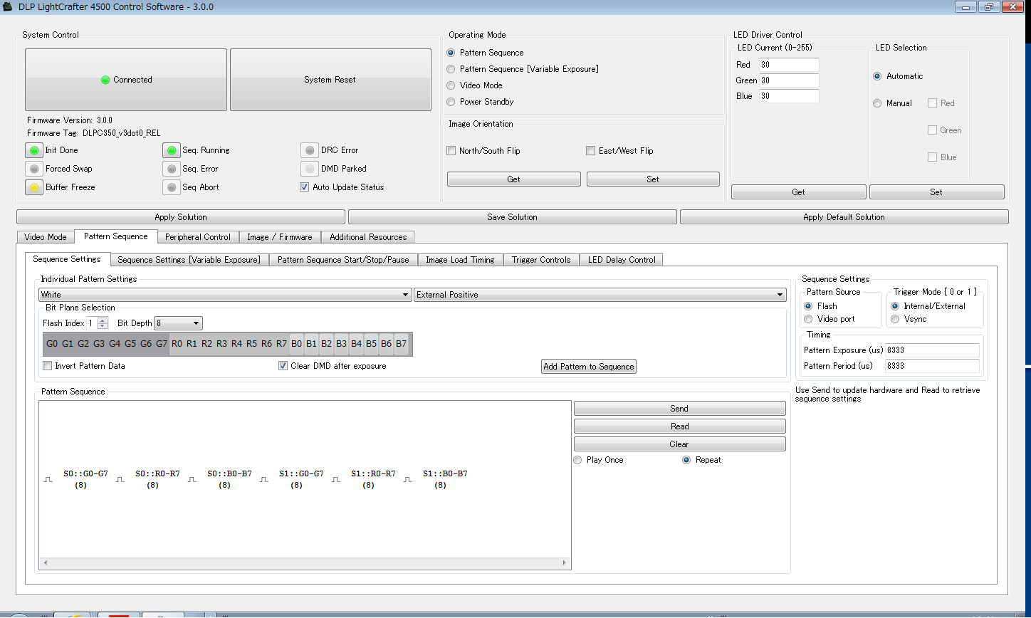

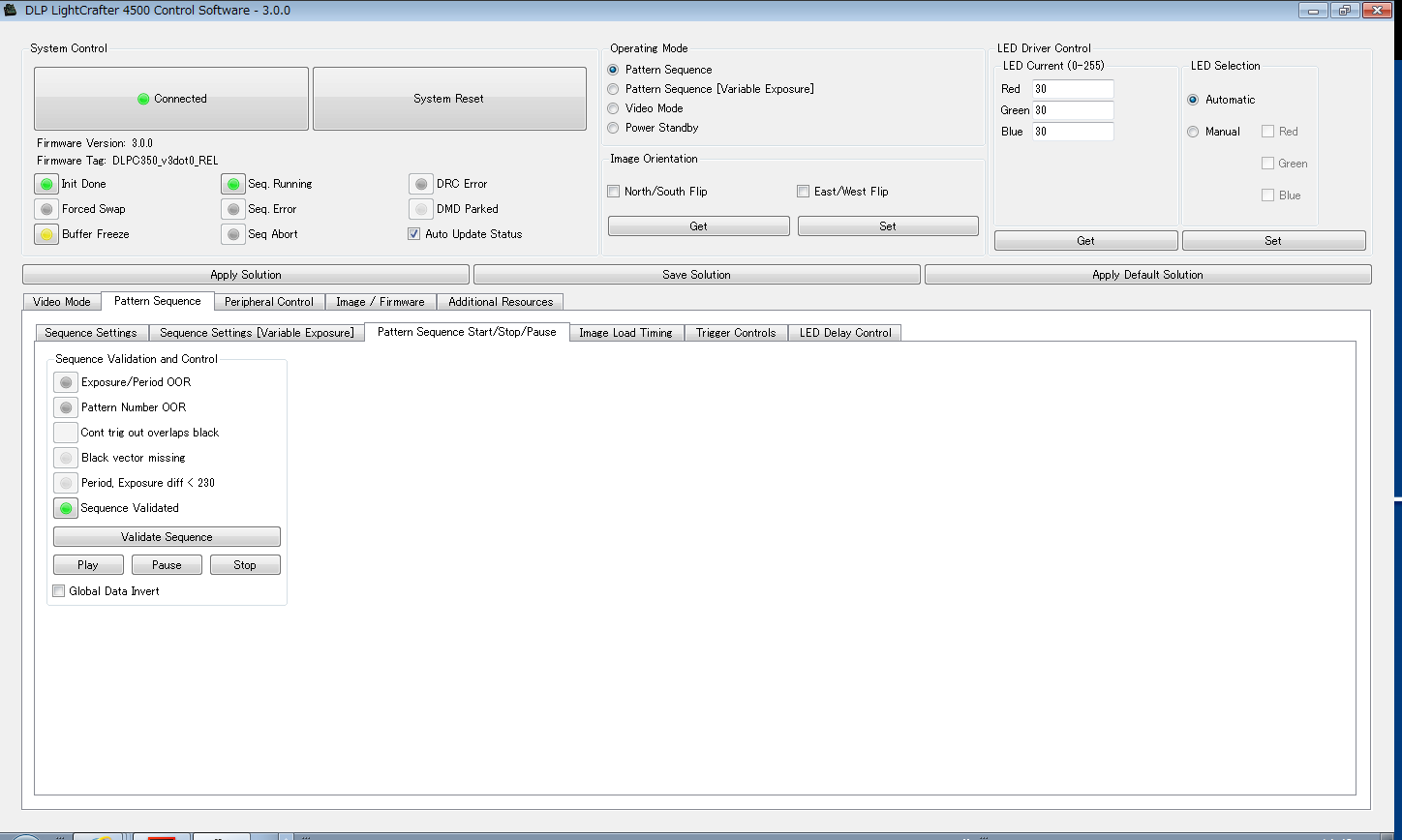

  • Paul-san,
    I asked them to send the movie file of the phenomenon but they cannot send it yet and they will send it to us a couple of days later.
    By the way, they captured the waveform of the trigger signal and LED signals in both normal and bad cases.
    So, would you please check the attached waveforms and give any comment?
    We also got the capture image of GUI tool. Please also check whether there is any problem or not.
    It would be helpful if you can give us any comment.
    Nobu Arai
    LCr4500_LED_Waveform.xlsx
  • Nobu-san,
    The GUI configuration looks correct. I appreciate the oscilloscope screen-shots, they are very helpful. I think I understand better what the problem is and I will try my tests again to see if I can replicate. Please give me some time and I will reply back here on my results.

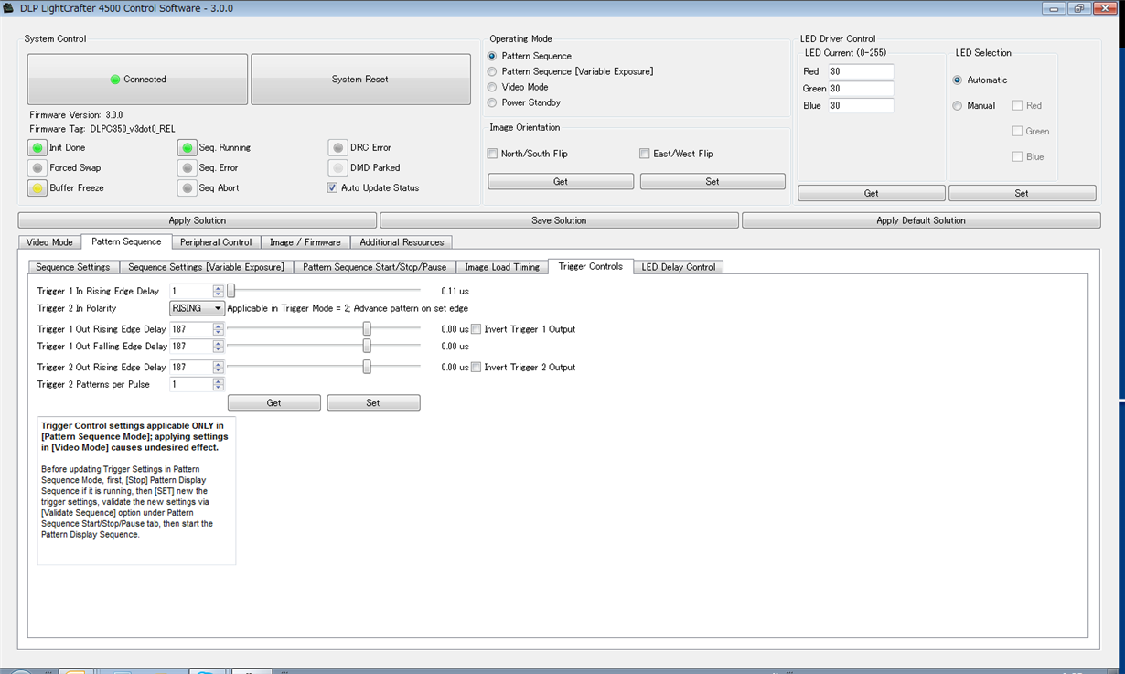

  • Hi Nobu-san,
    We exactly replicated their set-up and we are unable to replicate the issue - we would like to wait for the video.
    A few additional questions:
    1. The problem waveform doesn't make sense. The LED current is ON for much longer, which would give a very bright image, not a dark one.
    2. Why does the customer want to repeatedly turn on and off the external trigger?
    Could the customer please attach a screenshot of the "Trigger Controls" tab on the GUI? We would like to verify that everything is set as we expect it.

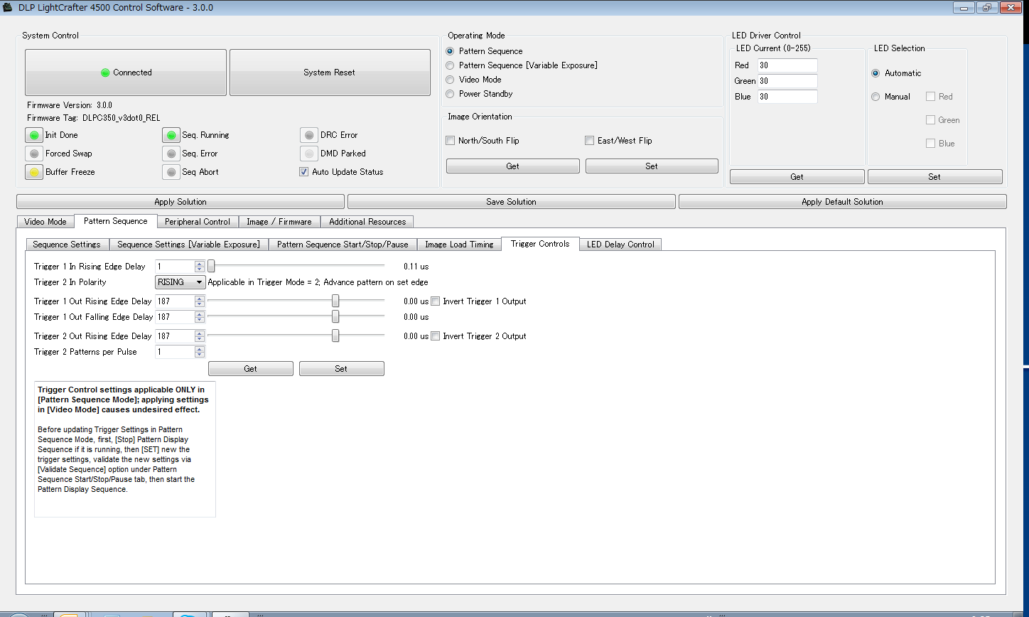

    Please see the following capture of trigger control tab.
