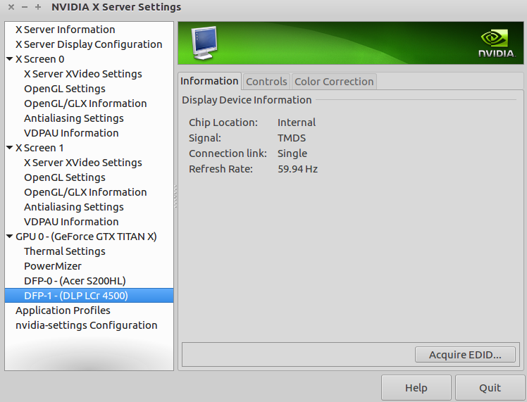

Ubuntu 16.04 with Nvidia GeForce Titan X (367.57 proprietary drivers) and projector connected via HDMI port. But  what I see it only 59.94Hz instead of  60Hz, and I'm working with Pattern Sequence with HDMI as a pattern source, with synchronization my camera  with Trig_Out_2, so really I need true 60Hz. Do you have any recommendation how to make it 60Hz?

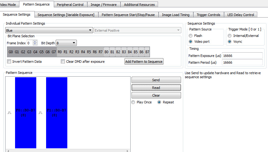

    Somethings is definitely mis-synced. Please see below screenshot with my setup. And with 60Hz I should see 30Hz  output right? Or something regular.

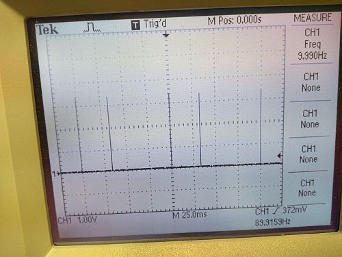

    and here is what I'm getting on the TRIG2_OUT - irregular pulses:

  • By any chance have you selected the 'Clear DMD after the exposure? This would add another 235us time, so your total display time become 16666 + 235 =  16901
    16901 > 16683us.

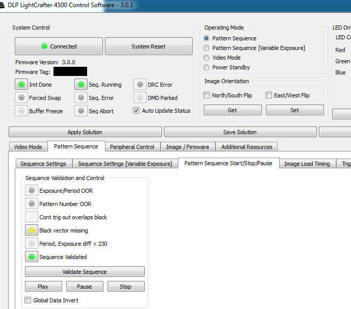

    The other option to ensure everything is setup properly is to ensure that the , Seq. Error or Seq Abort flags must be not lit, else DMD is not able to complete the display of the data, so you can adjust either pattern&pattern exposure to a smaller number or adjust the actual frame-rate on the graphics card.
    SAnjeev
  • Thank you SAnjeev,
    No "'Clear DMD after the exposure" not selected (please see solution export).
    Also there are no errors too.

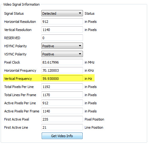

  • I'm not sure what to recommend - it appears that the video card is sending 59.94Hz because that's what the Lightcrafter is reading as the input. If there is no tweaking on the source side, I don't think there are any options available on the LCr4500 side of things.
    I am a little perplexed by your screenshot above because you are correct that you should see regular triggers. What does TRIG_OUT1 show?
