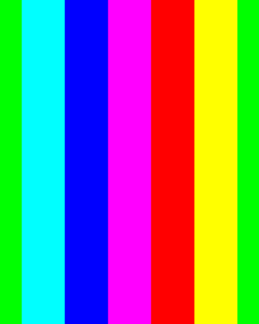

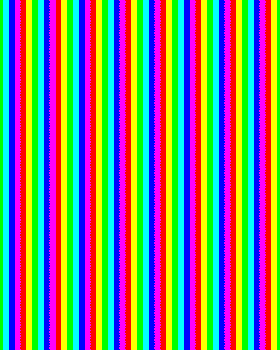

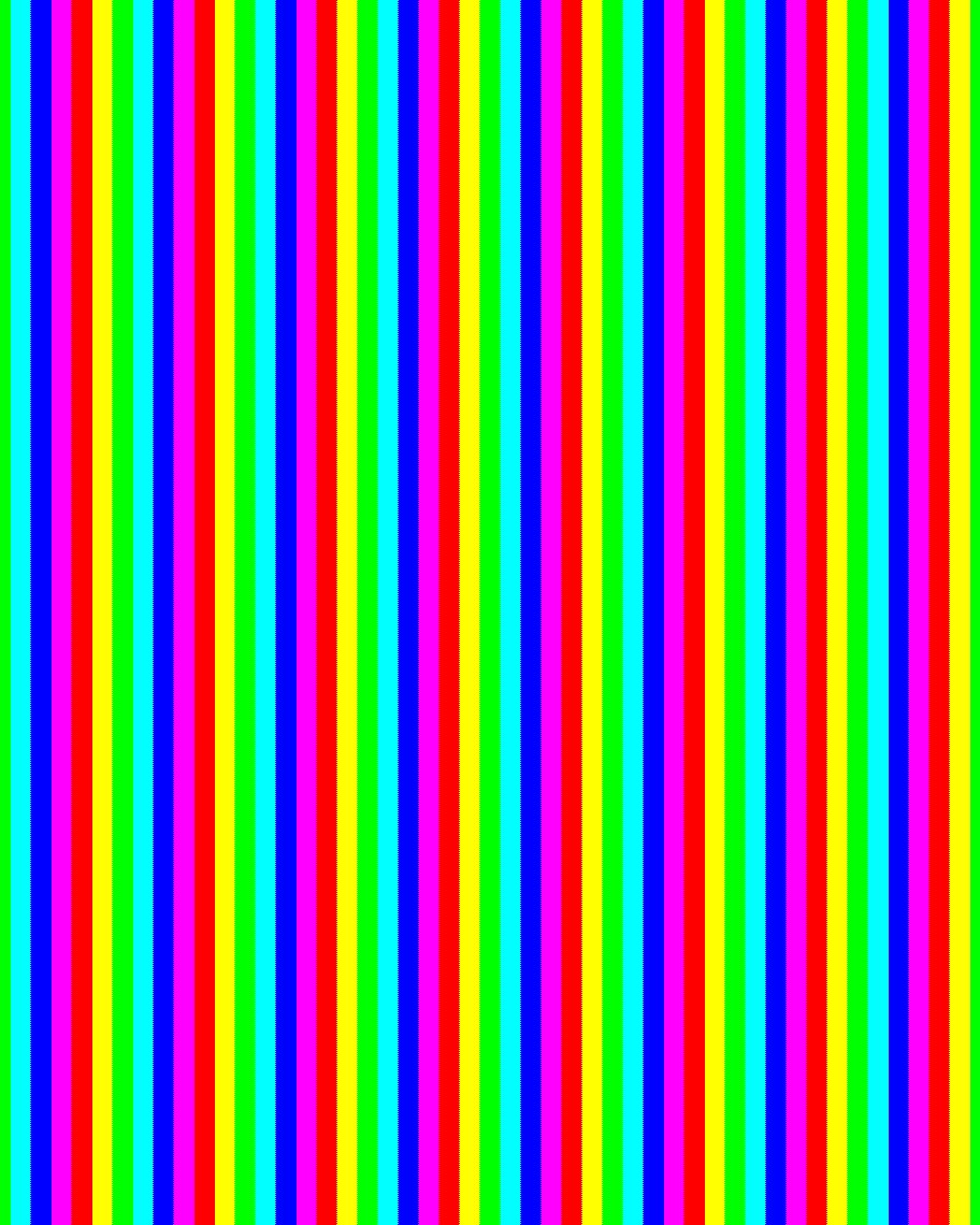

  • Hi Paul
    I have inserted two images for you to test with.
    I have used the "Insert File" button, which pasted the images in below. Is there a better way to post the files?
    Claus
