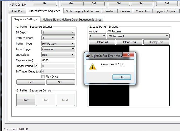

I got a DLP and upgrade to latest version
When i want to start the pattern sequence, it shows command fail.
Please HELP! T_T

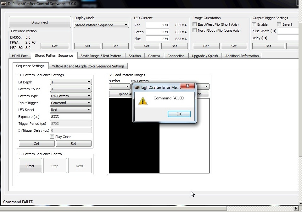

Please HELP! T_T

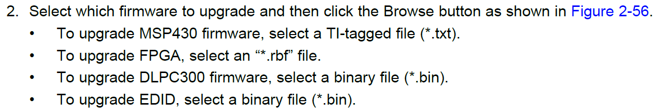

Hello Paul I have the same problem. Try to install the updates mentioned in section 2.13.1 subsection 2 (although they only mention the type of extension and not the name of the file):
My problem now is that when installing the update for the DLPC300, my DLP stopped sending images >( .
Could you send me via e-mail or say where I can download the correct updates to reconfigure my DLP correctly?

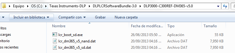

Thanks for answering.

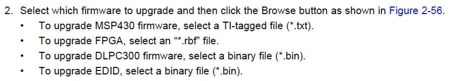

In Section 2.13 subsection 2 it is mentioned that the update for the DLPC300 is a .bin file, which does not lock in the folder >(
I show you what I observe:
Which one should I install?
Because I had already installed one similar to one of those 3 files in the previous version I had and was the reason why my DLP stopped emitting images >(.

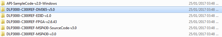

Hi Paul, its me again.
I downloaded the link file that you suggested, in which I found this file:
Which coincides with the file extension mentioned in section 2.13.1 of the data sheet.
But now my problem is that by mistake I upload an incorrect file on my DLP and I can not establish communication with the DLP via the DLPLighcrafter Control Software.
I do not know if I have to reinstall the DM365 Firmware and boot the device via a micro SD as mentioned in section 2.13.2.3. What should I do to get back to the factory conditions of my DLP?
I need help :(.
