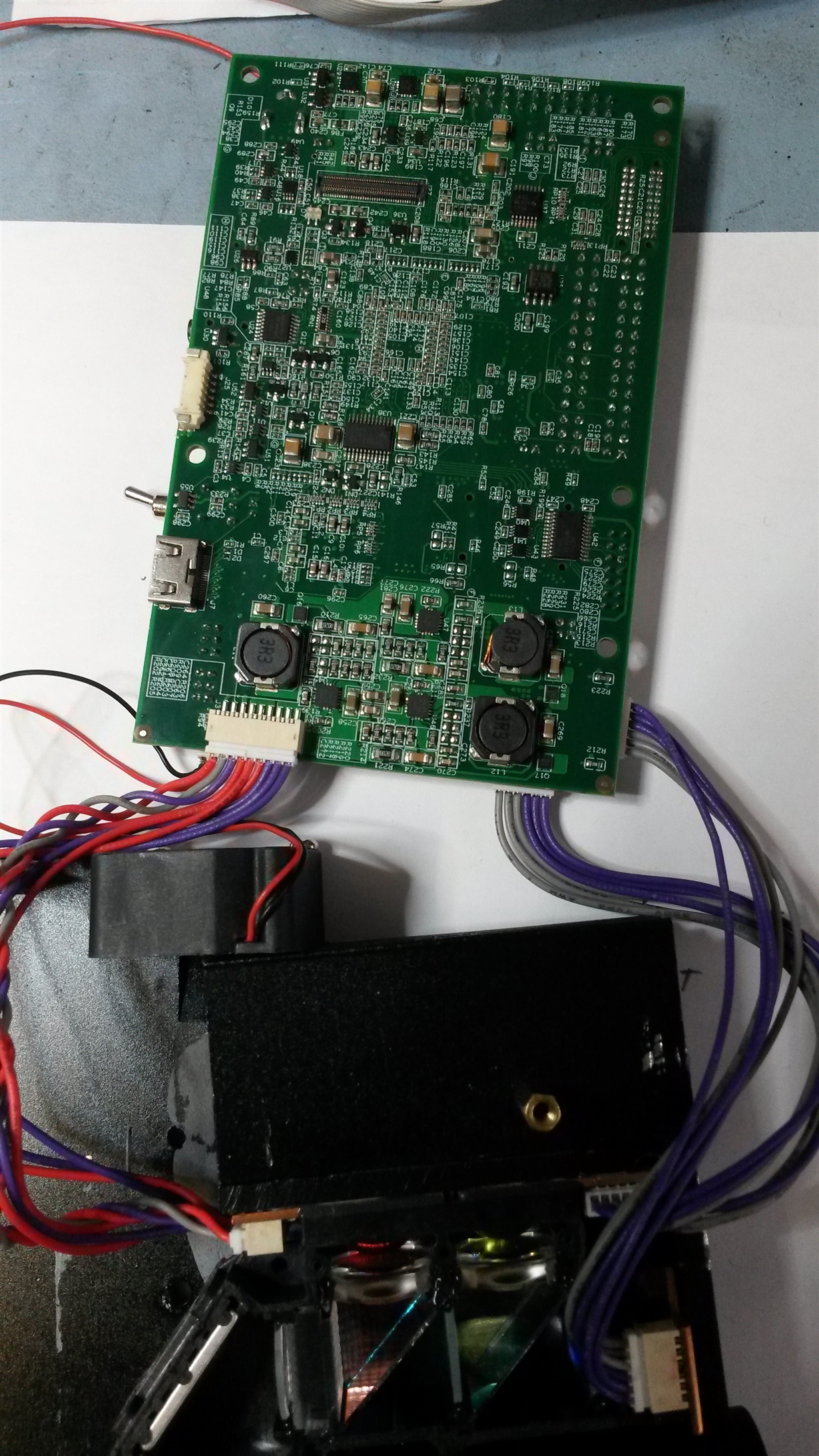

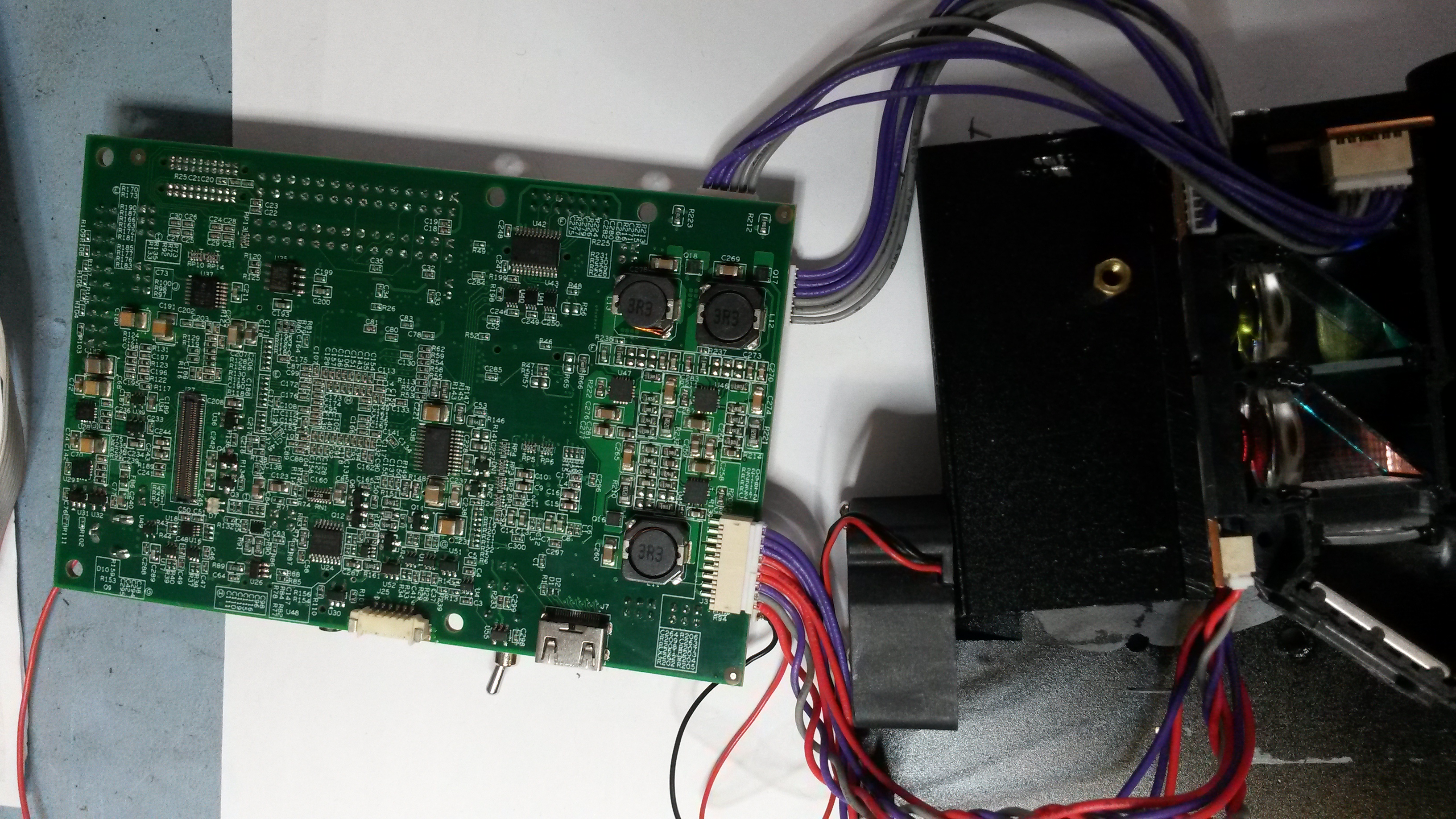

  • We tried to replace the DLP4500 on the control board of the DLPLightCrafter4500 with the DLP4500NIRFQE.
    However, the PC does not even recognise the device as a new heardware, although only the DMD with an identical pin assigment has been replaced.
    Everything else such as the LEDs are still connected to the control board.
    Do you have any idea what may have gone wrong?
    I would be very grateful if you could help me sorting out this issue.

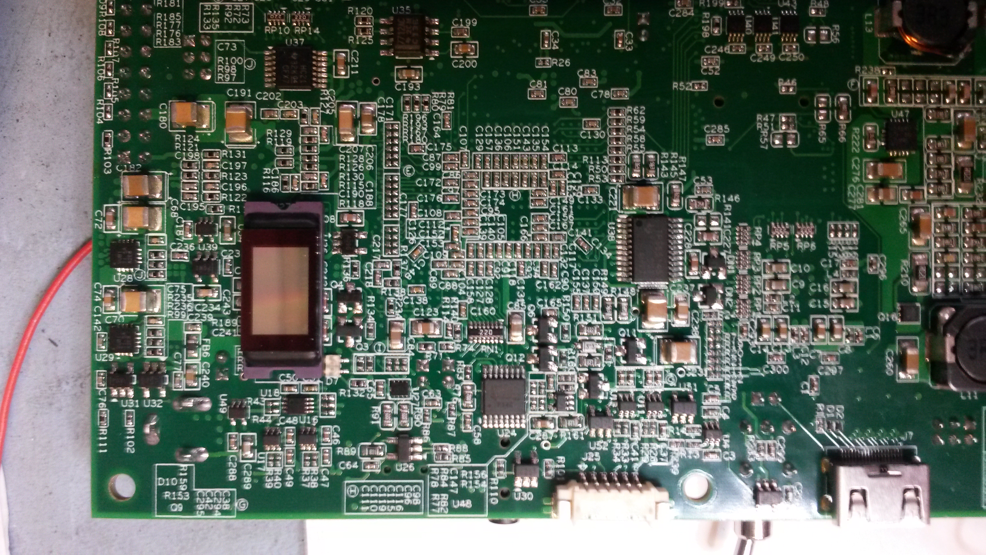

  • Great
    please find images attached. The first without the DLP4500 and the second with DLP4500NIR.
    We paid attention that the orientation of the DLP is in accordance with the previously connected cable of the DLP4500.
    When connecting the device the LED at position D7 lights up red, whereas when connecting the cable with DLP4500 it goes green and all works fine.
  • The fact that D7 is red tells me that there is an issue with the POSENSE signal. Are you able to attach the DLP4500NIR to the flex? Does it work then?
    I'll need some time to take a deeper look at the schematics and see if I can figure out why directly attaching doesn't work. When the DMD is attached to the connector directly, do any of the test pads contact components on the board? I'm thinking of possible shorts or other interference.
    -Paul
  • What is D4 doing when the DMD is attached directly to the connector?
    -Paul
  • Daniel,
    If you look at the datasheet for the DLP4500NIR and the schematic for the Lightcrafter, you'll see that the pin-outs are not the same, which means that the flex is not just a straight through flex and you will not get desired operation on the board by directly attaching the DMD.
    -Paul
  • I would reach out to WinTech Digital (EVM manufacturer and design house) for further information on the flex and the optical module. They might be able to provide you useful information to accomplish what you're looking for. www.wintechdigital.com/index.php
    We also have a design network partner which has designed their own NIR optics and hardware based on the DLP4500NIR. If this interests you, send me a friend request on E2E and we can discuss further offline.
    -Paul
