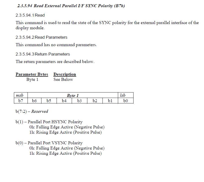

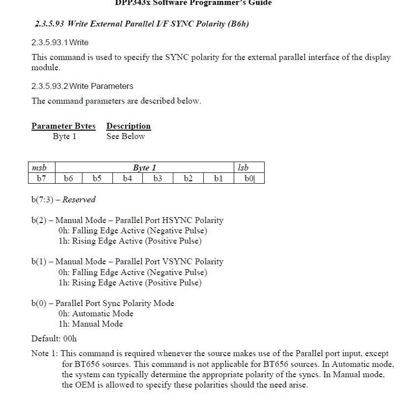

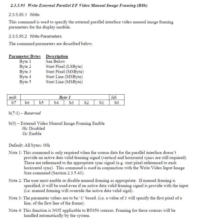

1) In the SW Programmer's Guide, where's the command to program the polarity of VSYNC, HSYNC, and DATAEN and the PCLK active edge?
DATAEN is optional.   Where is the command to enable or disable it?
See the datasheet section 8.3.1.1.

    I attached screenshots for the needed commands you were interested in.
