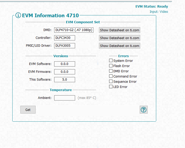

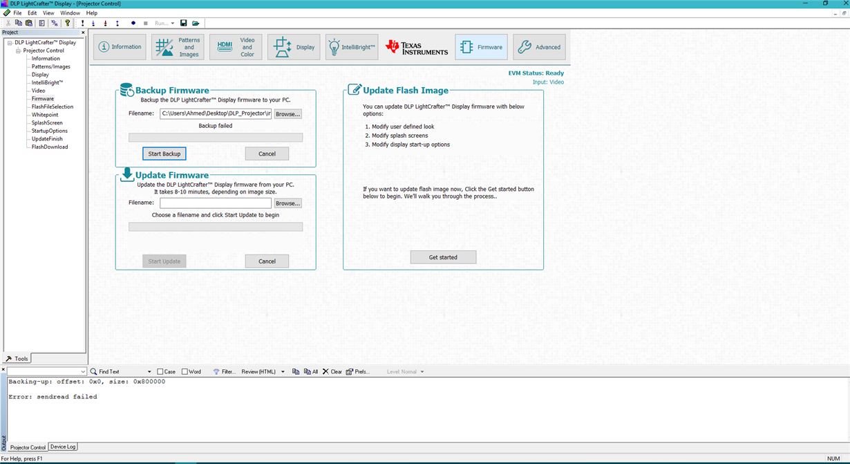

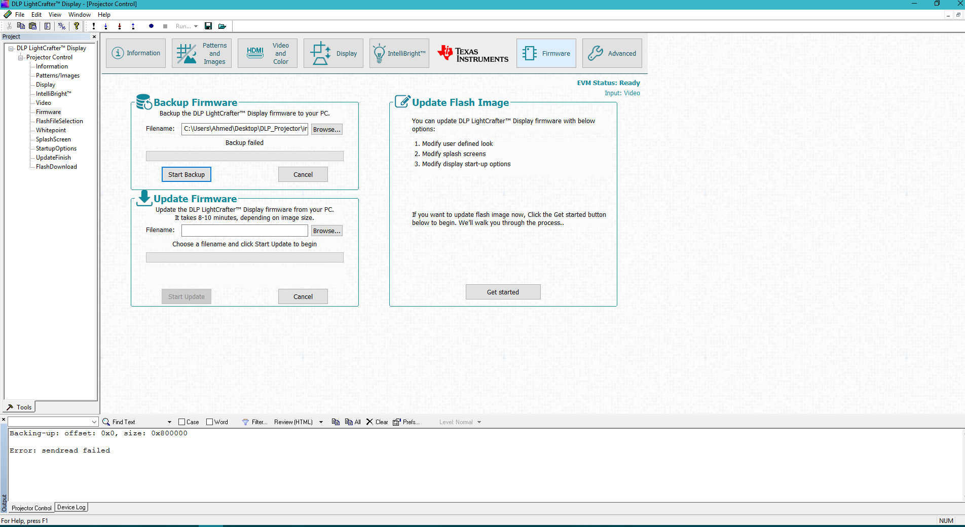

2. Using the DLP LightCrafter Display 4710 EVM-G2 GUI we are trying to backup the firmware but we get an error as shown in the images
Actually this is not the only issue regarding the DLP LightCrafter Display v5.0! Most of the features give an error while executed so we are wondering if something is wrong with the firmware.
We appreciate any help provided and we thank you for your time.

  • Hello Nadine,
    Thank you for your response.
    Yes the EVM is working when I start it I see the DLP Splash.
    I think none of the I2C commands is working ! I can't set a pattern or a splash screen. And as you see in the first image the firmware and software versions are 0 ( I suppose it cannot be 0.0.0).

  • Hello Nadine,
    I tested both signals after sending a splash screen request and both go high for about 150 ms. I assume that's the normal case but still get the "Read Cmd:SplashScreenHeader, addr:37, subAddr:f SendRead(FAILED(1))" message.
  • Hello Nadine,
    I think the problems are related to the windows 10 driver (yeah I forgot to mention I am using windows 10). I managed to perform all the features provided by the GUI in my laptop (windows 7).
    Thank you for your time.
