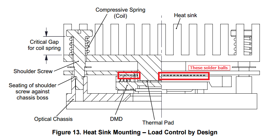

I have question about Mounting condition of DLP6500.
The following documents describe the load of Thermal Interface Area and Electrical Interface Area, Is it possible to install the DMD by equally loading only the Thermal Interface Area?
In other words, is it possible to fix the DMD only with Thermal Interface Area excluded Electrical Interface Area?

    Q1: It seems that the following DMD mounting concept are described as stressed only the thermal interface area. In the case of this structure, is the load evenly distributed to the electrical interface area?
    Q2: Is TI's system mounting concept considered for the load between DMD socket and DMD-PCB? I am concerned that the solder of DMD soket will crack due to the load that holds the socket and the DMD-PCB.
    H.U
  • Hello H.U.,
    Regarding Q1:  If the this mounting system is built according to the specification and using springs with the recommended spring constant then the load is designed to apply the correct pressure evenly to the thermal interface area.
    Regarding Q2:  Please note that the opening in the back of the socket and the holes through the DMD board do NOT apply preasure to the socket and its solder mount.
    The DMD board has holes larger than the shoulder screw.  Therefore the heat sink pushes against only the back of the DMD which in turn is pressed up against the optical chassis.

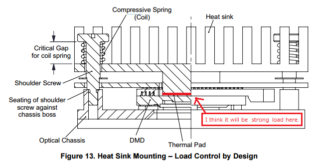

    Regarding Q1: Are you say that only the thermal interface area is pressed? If so, I think that this mounting system can not meet the specifications of the data sheet below.

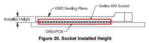

    Regarding Q2: The mounting system in the figure below, I think that the force to hold down the solder ball of the DMD socket will be added. I want to know the acceptable value of the stress added to this part.
    H.U
  • Hello H.U:
    It is not required to apply 11.3 kg to the electrical interface area, but up to (max).  You are correct that the DMD board will need to have some mechanism to apply some pressure to the back DMD board that will in turn be pressing against the solder balls and therefore pressing against the electrical interface area.

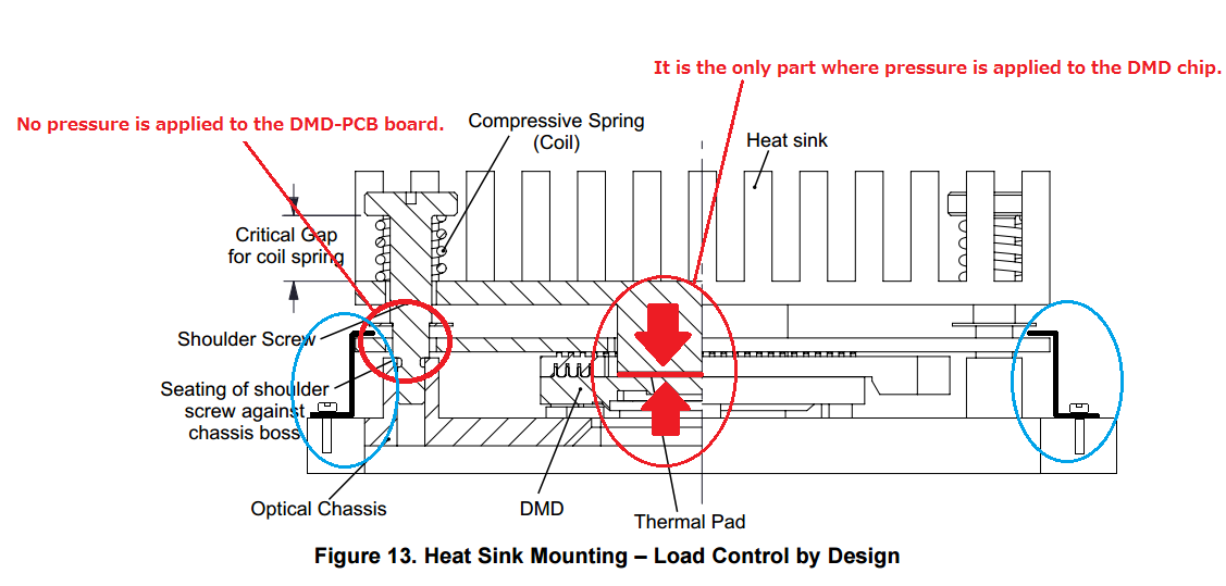

    I think that the heat sink is pressing against the Thermal Pad and the Thermal Pad is pressing against only the Thermal Interface Area. but it seems that no pressure is applied to press the DMD-PCB board. because, the DMD-PCB board only is prevented displaced laterally at the grounded part with the Shoulder Screw and the Push Nut. So I am wondering how pressure is exerted on the Electrical Interface Area.
    H.U
  • Hello H.U,
    Your understanding is correct.  No pressure is required against the electrical interface area.  However some kind of physical stop or mount needs to be designed into your system to prevent the DMD board (& socket) from pulling away from the DMD.
    You can have as little as 0 kg or as much as (but not more than) 11.3 kg pushing on the electrical interface area in your design.
    See the areas circled in blue in the image below.  These show a possible 0 force clamping system.  Such a clamp should actually lightly touch the DMD board sufficiently to keep it in place in the presence of expected vibrations in your application.  I hope this helps.
    Fizix

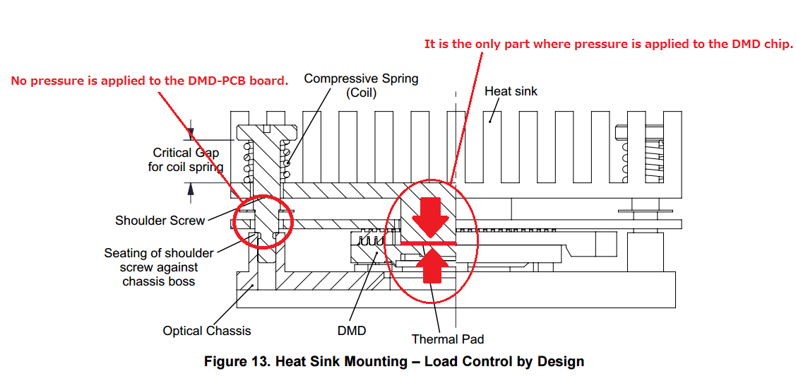

  • Hello Fizix
    Please let me reconfirm this to make sure.
    Are you say that the DMD can be pressured to only the thermal interface area, NO pressure is required against the electrical interface area?
    I think that I have to put pressure to the electrical interface area rather than the thermal interface area in order to satisfy the requirements of the system mounting interface loads.
    H.U
  • Hello H.U,
    That is correct NO pressure is required against the electrical interface area but it can handle up to 11.3 kgf.  The loads listed  are the maximum allowable but not required.  The heat sink needss a sufficient load to make good thermal contact with the thermal pad on the DMD, but the electrical interface area does not need any load.
    When you say, " . . . satisfy the requirements of the system mounting interface loads."  Which requirements are you referring to?  It is not the requirements from the DMD data sheet.  If your system requires a load against the electrical interface area, then the DMD data sheet only specifies the maximum load you can apply.  That would be your system specification.
    Fizix
