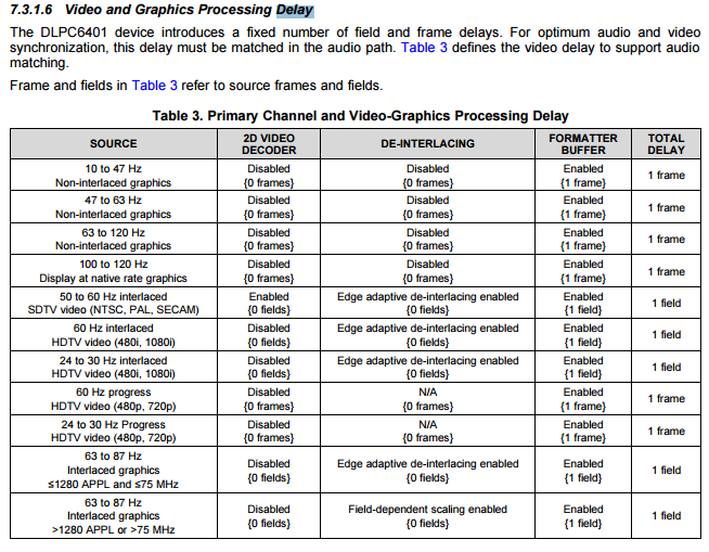

I have a question about synchronization of input and output images.
When using DLPC6401 for DLP4500, what is the delay of the output image relative to the input source?
H.U
Hi H.U,
Yes, you can use the table shown to know what the delay is.
For standard non-interlaced input there will be a 1 frame delay.
No, the Frame Buffer cannot be disabled.
