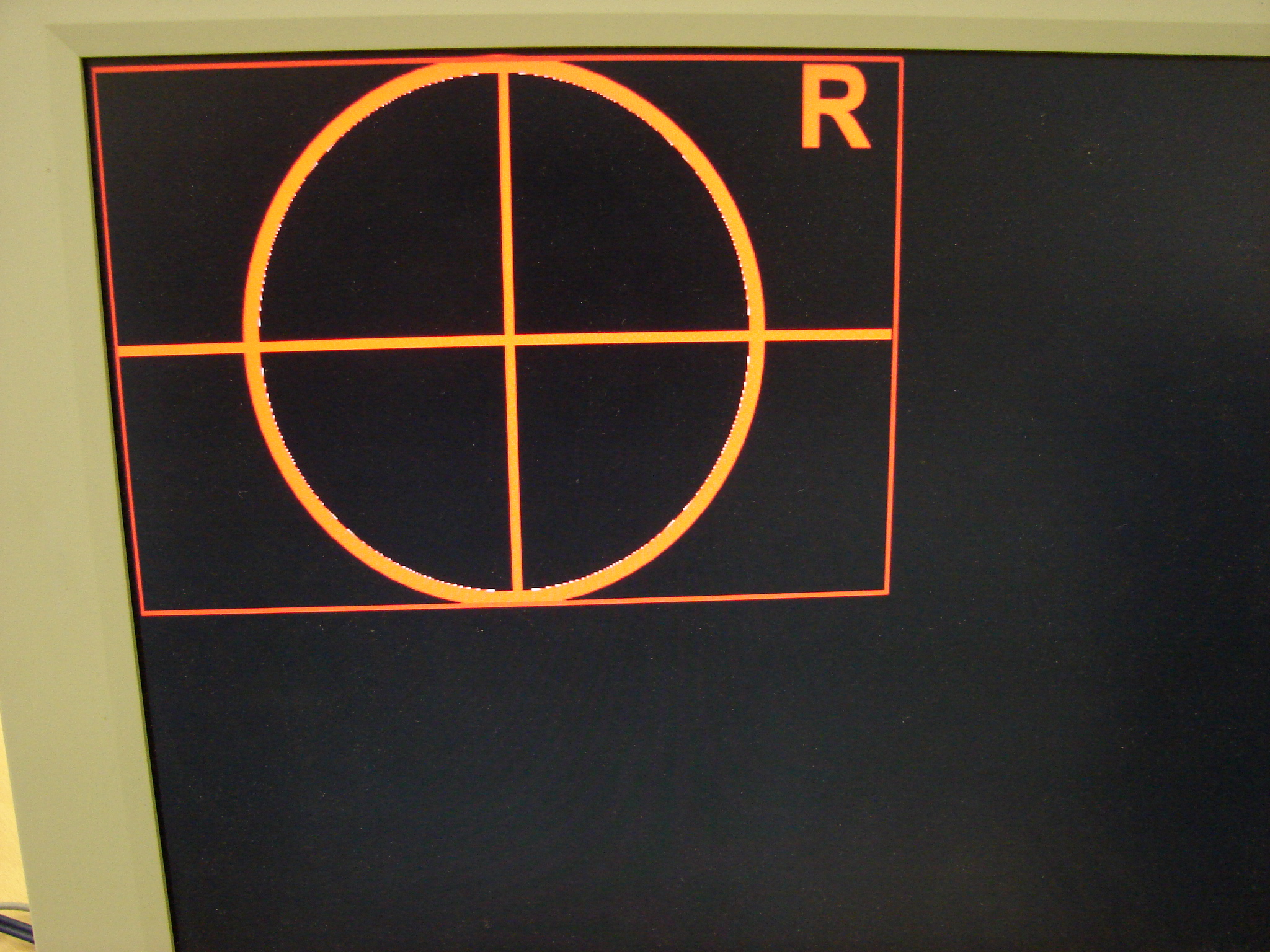

To start with here's the setup:
Pico -> Setup to run at 1440Hz (480wX320h, green led 33% PWM, all Non-linear functions turned off as specified in the Structured Light Applications document)
Feed src-> Windows box, sending a simple picture ( a black background with a red wire circle and a plus at its center)
I'd expect this to give me a bright circle and the plus sign and rest of the screen to be blank.

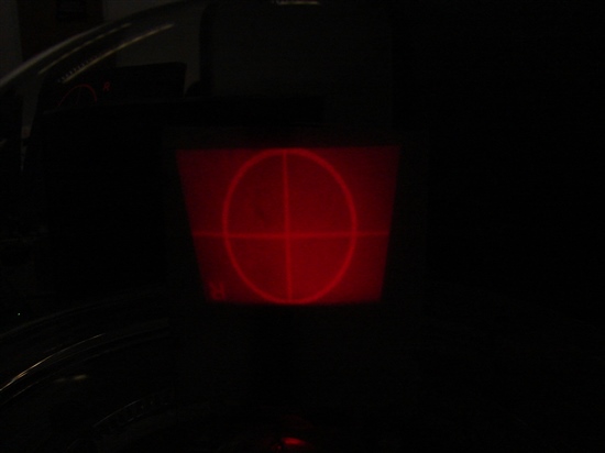

However the pico shows a very *noisy* background.
Is there some setting that I am missing here?
Warm Regards,
Abe
Src Image:
Resultant Image on Pico:

    First - you may not be doing anything wrong. However, I must ask if you reassigned the green LED to red? Only one LED can be used in the 1440 Hz structured light mode. You mention that you are setting the green LED for 33% PWM (intensity). However, the pictures that you attached are showing the light to be red.
    Second - in the 1440 Hz structured light mode, each 16.67ms frame is divided into 24 separate monochrome fields which display sequentially the values of the 24 RGB bits which are on the HDMI input port during that 16.67 ms frame. This RGB value comes from the image being displayed by the PC, as captured by the HDMI port. Each pixel location in the image has a RGB888 value associated with it. The 1440 Hz 1-bit structured light mode displays a bright or dark pixel during each of the 24 sub-frames corresponding to the bit value in each bit position on the RGB port. Figure 5 in the application note "Using the DLP Pico 2.0 Kit for Structured Light Applications" illustrates this.
    If the input image sets only a few bits on the RGB port, then the resulting projected image may have illuminated pixels for only a few of the 24 subframes. This would make the image appear dim to the eye. However, the "correct' pixels are actually being illuminated at the correct time. But the resulting visual duty cycle is low - therefore dim or noisy in appearance. By way of understanding this, if the image from the PC is 100% white (RGB 255 255 255) in the image area, then the subframes will display a bright pixel for each of the 24 subframes.
    Perhaps this is why you are not seeing what you were expecting. I hope this helps. If you continue to have questions or problems, please let me know.

    I understand what you are trying to say here. But the src image has a black background which is essentially RGB 0,0,0. And the shapes are RGB 255,0,0 This is exactly what created the question in the first place. I'd expect nice crisp (relatively dim) shapes in front of a black background instead of the noise I see in the black regions of the image.

    Pascal asked me to look into your setup to see if we could replicate the contrast issue you are experiencing.  I hope the following explanation helps you:
    I duplicated the setup you posted. I tried it with first the green, then the red LED enabled. I displayed an image with various regions of black (R=0, G=0, B=0), white (R=255, G=255, B=255), as well as regions with various RGB values.  I found that the Pico 2.0 kit worked as expected (as described in the Structured Light App Note) and displayed good contrast when the display values were black and white (as above). However, since in the 1440 Hz mode the 24 subframes display the RGB bits unweighted, it only takes a few non-0 bits in the RGB value to produce an apparently “noisy” or “grainy” image. Unless the black region of your image is actually RGB000, the Pico Kit will display it as a gray shade, even though the same region may look quite black on your computer display of the same image.  Again, this is because the 1-bit monochrome setting assigns all bits equal weight. This means that bits with little weight on your screen will affect the structured light mode projected image. For my test I gradually increased the brightness of my screen until it reached a setting where the monitor still looked black but the projected lines were grey.
