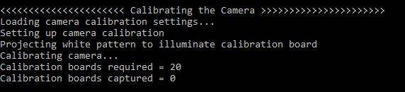

Helo, we are trying to follow the tida-00361 design reference for 3D scanning, but we're having some issues with the lightcrafter.
We have followed the instructions of tida-00361 till the camera calibration, where says that a white pattern will be projected, and we have no projection since the application started.
The camera identify all the 20 patterns with success (option 4).
When the option 5 is selected we got an error "LCR3000_SEND_COMMAND_FAILED".
We thought that should be some issues with the Lightcrafter, so we've downloaded the "DLP LightCrafter Firmware and Software Bundle - Windows" (Version 3).
When the GUI connect with the board we got an error about the MSP430 firmware version.
So we've tried to update the firmware, there is a txt file "lcr_msp430_v3.txt" inside the DLP3000-C300REF-MSP430-v3.0 folder, it looks like an hex file in ascii, but the return is "command Success" but the firmware version remains 0.0.
