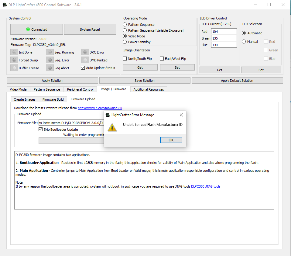

I'm working thru TIDA-00254 with a LC4500 EVM. After building the SDK on Ubuntu 16.04LTS, I ran DLP_LIGHTCRAFTER and during step 2 (Prepare DLP...), the software generated patterns for ALGORITHM_TYPE=1 (phaseshift) as expected and appeared to flash the firmware. But, the process reported a checksum error -- "Checksum verification FAILED". Some review of the source and debugging makes me think it failed on line 2124 of (lcr4500.cpp) at the DLPC350_CalculateFlashChecksum() call.
The config referenced the DLPR350PROM_v3.0.0.bin file
#1 - Is there something else I should be doing to get the pattern and firmware update to work?
After that, I tried using the "DLP LightCrafter 4500 Control Software" on Windows 10 to update the EVM back to the base DLPR350PROM_v3.0.0.bin file. The program connects to the EVM but fails to update it with error "Unable to read flash manufacture id" (see below) after the software tries to enter programming mode.
#2 How can I update the firmware back to the default v3 version?
