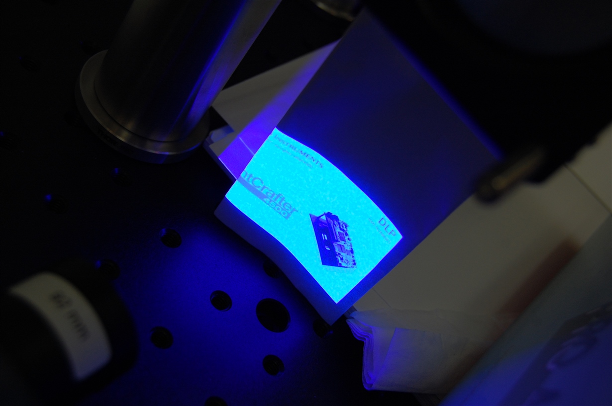

I'm trying to use the DLP4500 in video mode just like a second PC monitor. It is functioning well in "internal test pattern" mode and "images from flash" mode, but it keeps showing the same screen in "parallel RGB mode". Here is what I have done:
1. Updated the software and the firmware to 3.1.0;
2. In Windows display settings I set the DLP4500 to be my second monitor. I tested extension/duplicate mode;
3. I unplugged the monitor and connected the DLP4500 only to the PC;
4. Tried connecting the projector to two Windows PCs and a Raspberry Pi 3;
but none of the worked. Can anyone help me with troubleshooting?
Attached is the GUI screenshot when the projector is running.
