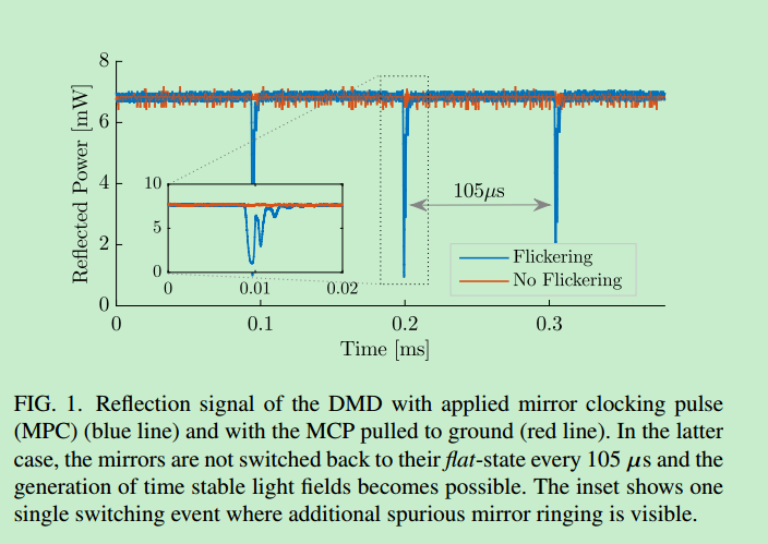

  •   Thank you for you reply,but I still have some questions.In order not to make mistakes,now I describe my experiment. We illuminate  laser on the surface of DMD ,by controlling the on and off state of the micromirrors we can get some special and static pattern (1bit-depth patterns displayed on the DMD are completely static and avoid fluctuations due to intensity modulation ,that’s very important).
       However,if the mirrors remain in the on- or o-state too long,the mirrors can either get stuck on the landing pads due to surface adhesion or deform due to the applied stress. For these reasons, DMD manufacturers usually implement a switching cycle which applies the MCP(mirror clocking pulse) every clock cycle, even if the pattern has not been updated.This is the mirrors flickering problem I’m describing.
       The figure shows the measured power vs time with all mirrors on, and their test device is DLP6500FYE implemented in the  Lightcrafter EVM 6500 kit  from Texas Instruments. The result is from the article--------’suppression kHz-frequency switching noise in the digital micro-mirror devices’. Besides,they solve the problem in the hardware level. They interrupt the mirror clocking pulse (MCP) between the sequencer chip and the actual DMD(by pulling the MCP to ground), effectively freezing the DMD mirrors in their present position. To load the next pattern from the sequencer chip to the DMD, the MCP is restored for a short time.
       I have read the user’ guides you give me ,if I choose the one of the three pattern modes(pre-stored pattern mode, video pattern mode, pattern on-the -fly mode),and upload one 1- bit-depth pattern,and set the exposure time to 50s. Does it mean that in the 50 seconds all mirrors won’t  flicker like the result of test where reflecting power decays suddenly every 105 microseconds? Is DLP® LightCrafter9000 Evaluation Module different from Lightcrafter 6500 EVM regarding this problem?
  • Let's separate the evaluation phase of a project and a final system implementation phase. The LightCrafter 9000 is indeed just an evaluation module that you can give any pattern you like and test out the device's capabilities. We do not add extra mirror cycling to any evaluation module.
    When you design your actual system, then it is a good idea to cycle the mirrors now and then as your application allows. Only a final system implementation where the system designer deliberately programs the device to do so will have the "flickering" you describe. There is even a special function call you can use to exercise the mirrors in this way. But, again, TI does not force the EVM or any device to do that. It is up to the system designer to determine when and how to do this. The DLP chip only does what the programmer tells it to do.
