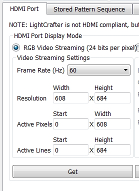

    This is  a perplexing issue and one that I haven't seen before. In the spirit of continuing to try different things because I don't have this issue here, have you played with the video streaming settings at all on the GUI? Maybe you can see what the impact of these settings are on your video signal and if you're able to fill the DMD by adjusting them.
