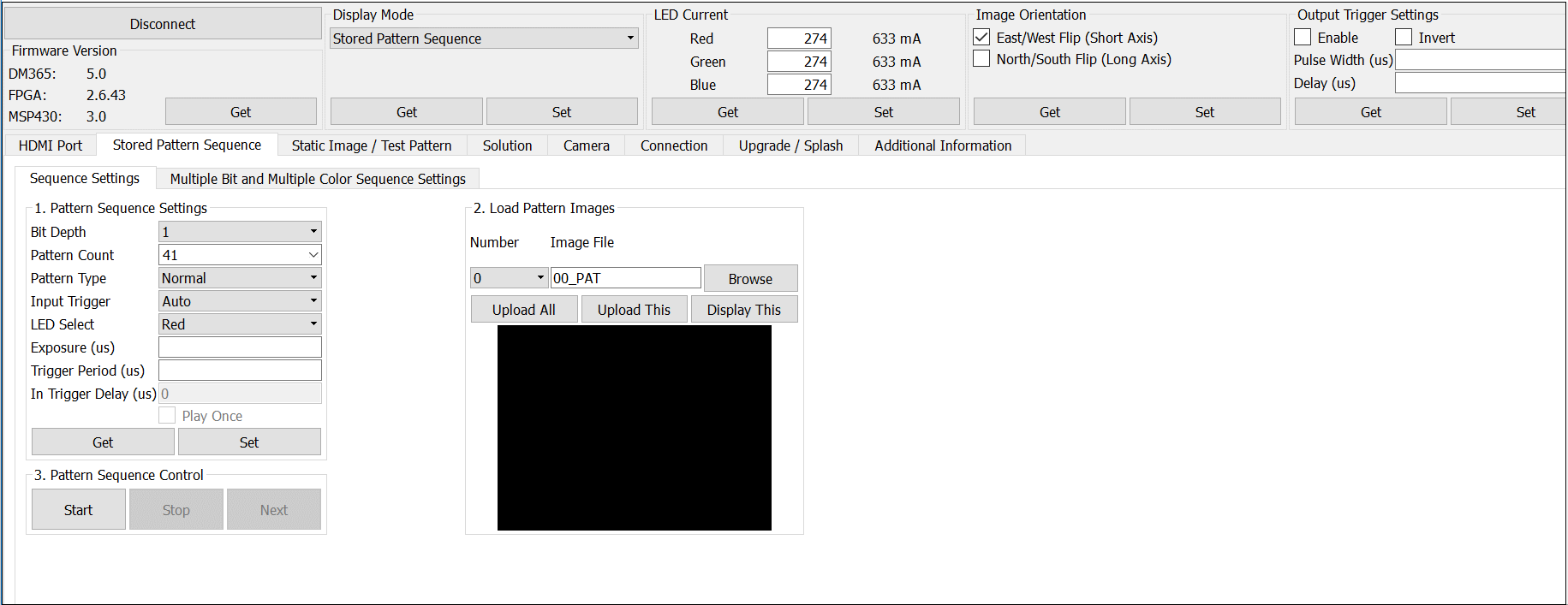

  • Thanks for replying, Paul. Before getting a MBMC, there's another thing I wanna try. But I'm not sure if I should create a new thread or add on to this thread. Do inform me if you think it's better for the community if I post the question below onto a new thread.
    I'm using the "Stored Pattern Sequence" with the current settings:
    Bit Depth: 1
    Pattern Count: 41
    Pattern Type: Auto
    LED Select: Red
    Exposure: 18000
    Trigger Period: 18330
    For the exposure and trigger period, even if I were to put smaller values and "Set" it. Whenever I "Get", the values will always be set to 18000, and 18330 respectively. I have two questions in this case:
    1) Is 18000, and 18330 the minimum value given bit depth of 1 and pattern count of 41? Is there a way to minimize this further?
    2) The trigger period will always be Exposure + 330 microsends, or 18000 at least. Is this another limit imposed?

  • I'm surprised that you're seeing a minimum exposure time of 18,000. It should support much lower times for binary patterns. You're using the latest GUI/SW?
    As far as the trigger period being greater than the exposure, there is a limit due to the time to load the DMD. I should correct one of my previous responses to say that there will always be a gap between the exposure and trigger periods.
  • Weird, now I'm able to get the exposure to be 333 microseconds, but the trigger period will still default to 18,000 microseconds when I "Set" a smaller value, and press "Get".
  • Strange. I would recommend restarting the unit and starting the pattern configuration over from scratch. It shouldn't limit you to 18,000us.
  • I've restarted the unit and the issue persists. I've captured a gif of what I did. Maybe you could identify some errors from it. Thanks.
  • Hello Jing Yang Kwek,
    We were able to replicate your problem. It appears there is a bug when selecting 41 patterns that the trigger period will go to 18000us. However, if you are able to use 40 or 42 patterns for your application the 333us will have a trigger period of 468us. If you are able, try to stick to the predefined pattern counts in the dropdown menu (I noticed 40 and 42 are default options but not 41). If you need exactly 41 patterns let us know!
  • I see. Is it possible to have 41 patterns exactly?
  • We don't see any reason it shouldn't be possible. It is likely a software bug. If 40 or 42 patterns work for you that would be your best bet. If you need 41 we will need more time to investigate and find a solution.

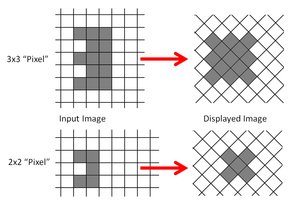

  • To add on, if I were to need a pixel to be approx 1.15mm and 1.12mm (horizontal x vertical). How do I do the calculations to achieve so?
  • What type of timing are you using with the photodiode to capture the pixel? You're not going to be able to get around the load time of the DMD, so you'll need to adjust how you trigger your measurement.
    For the pixel size calculation, I think the easiest thing to do is:
    * Assume a pixel size of 1.15mm by 1.15 square. Because of the diamond orientation of the DMD, you are really concerned with the length of the diagonal across the square pixel, which is 1.15*sqrt(2) = 1.62mm
    * There are 608 diamond pixels across the top edge of the DMD.
    * Multiply 608*1.62mm to get the total width of horizontal projected image, which is ~985mm.
    * Move the projector position until the measured length of the top edge is 985mm and your pixel size should be ~1.15mm by 1.15mm

  • One issue I have now is that to produce a project whereby the top edge is 985mm, I have to hold it at about 1.6m away. The brightness on the surface is affected greatly by this distance, and it makes it less detectable by the photodiodes. In order to increase the brightness, I would have to adjust the LED current? But to do so without additional cooling would be dangerous?
  • You could brighten the LEDs by increasing the current. How much you can increase without cooling is covered in the user's guide.
    Another option would be to simply increase the number of pixels you use to create the projected spot. If you create a square on your bitmap which are you loading to the Lightcrafter which is more than a single pixel, you'll be able to put the projector closer and get more brightness. The image I show below illustrates this mapping. The more pixels across you use to create your spot, the closer you can put the projector, therefore increasing your brightness.
    Now, the math becomes:
    (desired spot diameter) / (width of spot in pixels) * 608 = Horizontal Projected Dimension
    I hope this image and the calculation make sense.

  • I see. Do you have the formula to calculate for the vertical projected area?
  • I have not verified this, but I believe that it would be:
    For a spot which is single pixel --> (radius of desired spot size)*684 = Vertical Projected Dimension (VPD)
    For a spot which is multiple pixels --> (diameter of desired sport size) / (number of vertical pixels in orthogonal image) * 684 = VPD
    For clarity, when I say the number of vertical pixels in the orthogonal image, I mean how many pixels tall is your "spot" in the input image. As an example, look at the 2x2 spot in the image above. It consists of 3 pixels in the vertical dimension.
