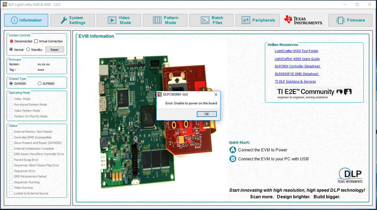

However, the DLP does not activate or run the sequence of patterns as shown in the included manual. Additionally, when running the DLP GUI over USB, the software cannot identify or contact the DLP.

    Are you able to get a screenshot of the GUI page after you have physically connected the kit and turned it on?  If so, please insert that into your supply.

  • Thanks, Fizix. I have attached a screenshot of the GUI after opening, connecting, and hitting the 'Normal' radio button.
    I see no changes on the DMD when I plug in HDMI, DisplayPort, or USB.
  • Hello Theodore,
    Thank you for the screenshot. Clearly the GUI is not seeing the Board. You have verified that the voltage is getting to the board.

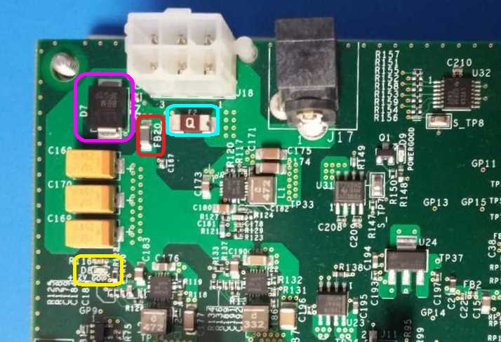

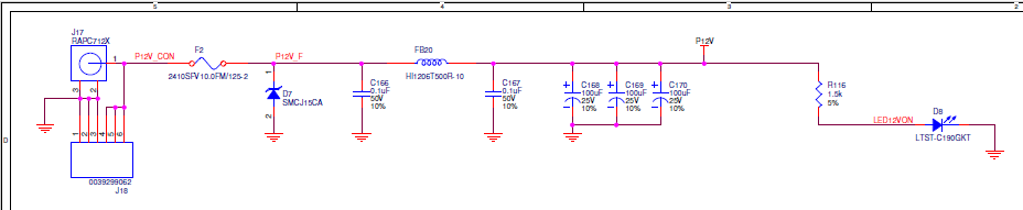

    Referring to the image below, using your meter, please verify that there is 12 Volts (relative to ground) on both sides of F2 (main fuse on controller board - cyan rectangle) and that D8 LED (yellow rectangle) is lit.
    Then verify that there is 12 Volts on both sides of FB20 (red rectangle).
    NOTE:  D7 (magenta rectangle) provides a good ground and a point connected to the downstream side of F2 and the upstream side FB20.
    Here is the input power section of the schematic (pg 15) for reference:
    Here is a photograph with different components mentioned highlighted by rectangles.
    Please report the results.
  • I have completed the tests.
    F2 has 12 volts upstream and 0 volts downstream—this may be the root of the problem, if the fuse is inoperable.
    D8 is not lighting, and has 0 V on both sides.
    0V on both sides of FB20.
  • Theodore,
    THANKS!  Yes the fuse is blown.
