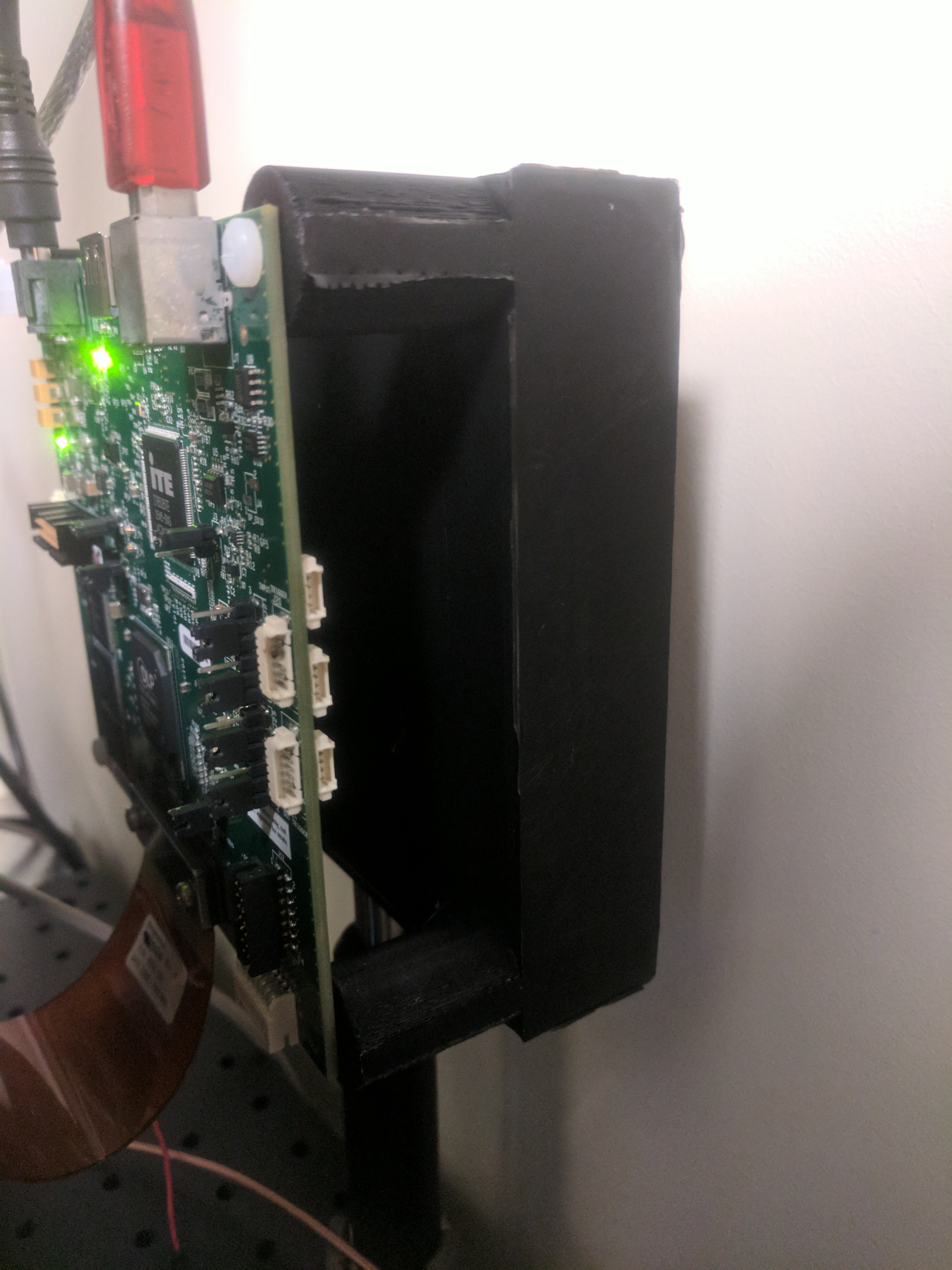

We are trying to trigger our DLP Lightcrafter 6500 DMD by input trigger J20 as described in the manual. We had this working a couple of weeks ago. However, recently the connector to J20 ( Digi Key part number WM1724-ND) has been melting immediately after it is plugged in to J20. The Digi Key connector has six wires that connect to the six pins on J20 but it is not connected to the teensy microcontroller we are using for this project, when it begins to melt. The J20 input has sustained some damage that can be seen in the attached photo.

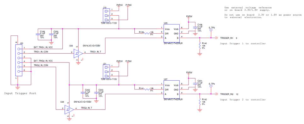

    Below is the circuit surrounding J20 and the trigger input.  In your picture you have jumpers on J19 and J21 which select the on-board 3.3V supply for devices U25 and U27.  In this mode of operation, there should not be any wires coming into pins 1 and 4 of J20 as this would imply a shorting of this on-board 3.3V supply to whatever is at the other end of those wires.  It is okay to leave the pins unconnected.
    If these were connected to other current sinks or different potentials, then this current flow could be the cause of the connector melting.   Please note that the board will also be expecting input voltage levels of 0-3.3V on J20-2 and J20-5, and that J20-3 and J20-6 should be connected to your ground reference on your micro-controller board.

    You can replace the connector, but it is not certain that the board traces have not been damaged.  This is the correct connector for triggering, but there does seem to be some kind of short somewhere.  Please be sure that the jumper shown is in the correct position for your use case.

    Why are you holdinging Pin 2 (TRIG1_IN_CON) high since you are using Pin 5 (TRIG2_IN_CON).
    You need a stereoscope to inspect the traces as best as possible.  Also check that you have J21 with pins 1&2 jumpered (i.e. 3.3 V).
    Beyond that, use the mini schematic above, to make sure none of the traces are now shorted.
