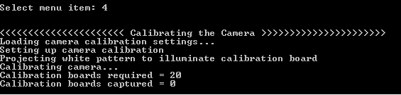

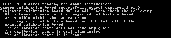

I am working on DLPLCR4500evm for creating accurate 3d point cloud. at the very first steps of using the TI proposed application for driving the DLP evm and PG camera, i have a problem for calibrating the projector.
The problem is when i try to perform the projector calibration procedure , the projector does not project the calibration board. in this step i have the live video and when i hit the space bar, i receive an error saying projector calibration board not found.the error is shown below:
also i should say that i can complete the camera calibration process. but at the beginning the projector does not project any white pattern to illuminate the calibration board.
thank you for your help

  • hello again;
    my problem haven't been solved yet, paul.
    Do you think maybe it should be related to USB 3 port?
    because I am using USB 3 port of my laptop and i don't know it has a suitable interface card or not?
    As you said, I performed prepare projector step and loaded correct firmware "DLPR350PROM_v3.1.0.bin" but the problem didn't solve :(
    Also when I set up calibration_camera in config folder to produce 7*10 chessboard it produce 8*11 chessboard.do you think it may be related to this issue?I did step 4 completely and reprojection error is 0.48 but step 5 is still as it was last 2 week.
    best

  • Hi paul.
    I really enjoy when read your complete answers and paying attention for solving my problem.
    In this message, I want to explain different parts of the system completely and the solutions that have been made to solve the problem  but the problem remains:(
    for the first step I want to show you dlp4500evm top surface and please check it for me is there any jumper that i don't place it?
    it should be noted, in this condition D4 blinking and fan is on.
    also I am using FL3-U3-32S2M-CS  point gray but the connections between evm and camera will be shown in the next steps.
    As I said before, I performed the first four step completely and the camera.xml has been generated although in step 4 the white pattern does not illuminate from projector but all of 20 pictures were saved and camera.xml was generated. you said me before, this issue may cause for connections between camera and evm and triggers which haven't been sent from camera to evm. also step 5 doesn't have been performed because of this issue ,and trigger signals should be sent to trigger input connector from camera to evm.
    but connections between camera and evm:
    first I connect camera cable to to j11 as i show it in below picture. I think the pin numbers of j11 start from left to right so pin 2 of this connector should be attached to red  wire of camera cable and pin 3 of j11 should be attached to brown wire. Also i tried it vice versa which means I suppose pin numbers start form right to left but still doesn't work:( also i tried input trigger 2 which is pin 5 of j11 but still doesn't work.
    Also I use scope  to check the trigger signals are generated or not? when i run the application the triggers signals generated by camera as you see in below picture and when I change the frame rate from camera.config the frequency of pulses will be changed correctly and the voltage level of trigger pulses are about 3v. but the interesting point is here when I connect pin 2 of j11 to red wire and check the signal from scope Simultaneously the trigger signals are destroyed(0v) in this condition I cant see camera trigger signal between red and brown wire but I can see it between red wire of camera cable and pin3 of j11.
    in previous message that i received from you, you mentioned check jumper number 13 and when I searched it from dlpu011f,it is related to external trigger output connector while in the schematic file shows we should connect cammera to j11  nevertheless after that I place the camera cable to this connector and in  each position(left or right. but still doesn't work.
    Also I check pattern sequence mode from gui and all of the pattern are saved in flash and i can see illumination of this but without camera and triggers so the firmware file is uploaded correctly.
  • Thank you Hadi for the detailed information and background. Let's work through things one at a time and make sure everything is okay.
    The first thing that I noticed is that your camera is a rolling shutter camera, which has to be accounted for by the software. Can you please look at {installed directory}\TIDA-00254_3D_Scanner_LCr4500-2.0\LCr4500_3D_Scanner_Application_v2\config\config_camera.txt?
    You should set PG_FLYCAP_PARAMETERS_PIXEL_FORMAT = MONO8.
    I would also recommend slowing down your exposure and frame rate to the following:
    PG_FLYCAP_PARAMETERS_SHUTTER_EXPOSURE_MS = 66
    PG_FLYCAP_PARAMETERS_FRAME_RATE_HZ = 15
    Then, in config_projector.txt (found in same folder as above), set the following:
    DLP_PLATFORM_PARAMETERS_SEQUENCE_EXPOSURE_US = 16666
    DLP_PLATFORM_PARAMETERS_SEQUENCE_PERIOD_US = 16666
    What we are doing here is slowing everything down to see if that helps account for the rolling shutter behavior.
    I looked at your board and all the connections and jumpers look correct, so that eliminates a number of possible issues.
    Let me know if changing those settings helps this work.
    Paul

  • Next step is to make sure the triggers are correct. Do you know if your camera outputs a positive or negative trigger? You can play with those settings in the same files that I pointed out. Fully investigate your camera and understand how trigger signals are generated (voltage and polarity).
    Paul
  • Hello again paul,
    I investigated all of the solutions that exist. I'm really confused which is the next step. I played with all the cammera and projector setting in config files. but the biggest problem is here, I should change the trigger source in config.projector.txt in internal one, because at least in this situation the projector project some patterns and white pattern in the correct position,however when I changed it to external there aren't any projected pattern or white pattern in each position on the surface. this change destroy each step of scanning.
    if, it is possible I ask you,tomorrow whe have a skype call please to show you all the obstacles and you see all the settings.
    The employer has put a lot of pressure on me to come up with the answer to this part of the project, but unfortunately this part is without the slightest progress.
    thanks alot paul
