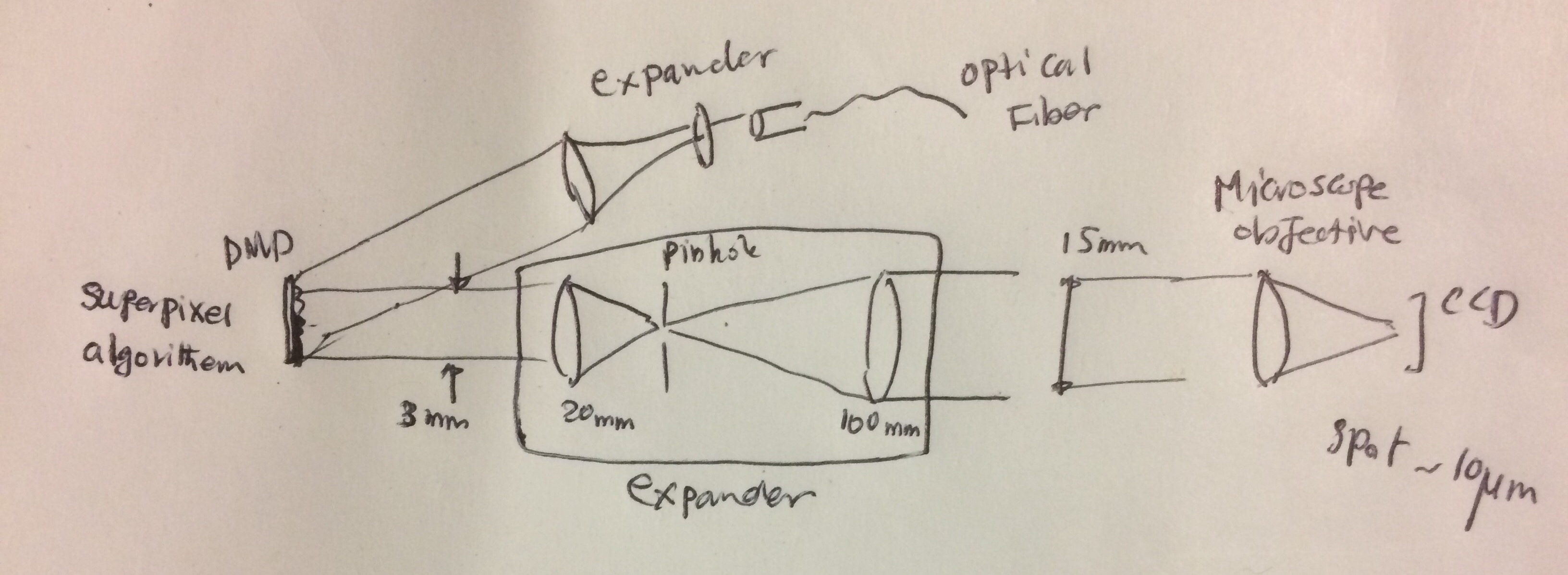

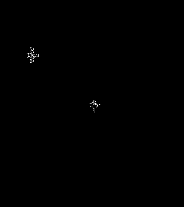

I have an issue with intensity fluctuation of the image created by DLPlightcrafter3000. This is    the fraction of a second. I have included the setup, the pattern on the DMD, the movie on the CCD after a microscope objective. The image is in the order of 10um size. Since I want to use this for quantum gas microscopy, I need to have a very stable intensity and I am sure about laser intensity fluctuation. I have heard that there is refreshing mirror sequence which is running for every sub-second. I am looking for a way to disable this refreshing sequence or at least make it less frequent (every several seconds). It would be great to help me.

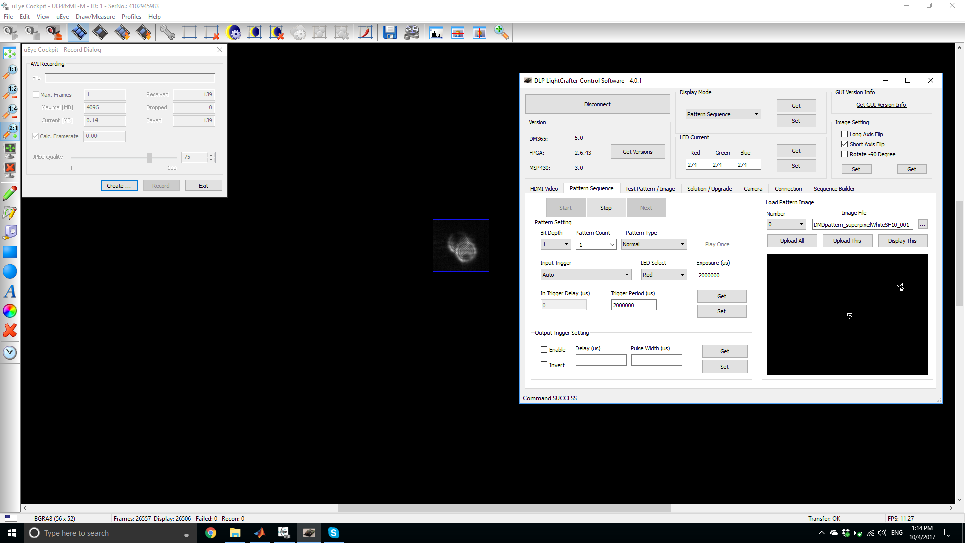

    Thanks for your suggestion. I have learned a lot after playing with sequence part but I do not think the fluctuation that I mean is related to this. I have run two cases:
    1. Video 006.avi and corresponding setting in figure 006.jpg: sequences with 2 second exposure time
    2. Video 007.avi  the static image.
    It seems these two are identical from fluctuation that I mean.
    I have heard that there are refreshing steps between even static images to prevent mirrors to stuck on their states after some times. it seems this will prolong the DMD lifetime. I am thinking to remove this step from the whole protocol but I do not know how?
    Have you ever heard about this issue?

    When you did your test, what bit depth patterns did you set? I believe that you will get the behavior you are looking for if you select 1 bit per pattern.
    -Paul
