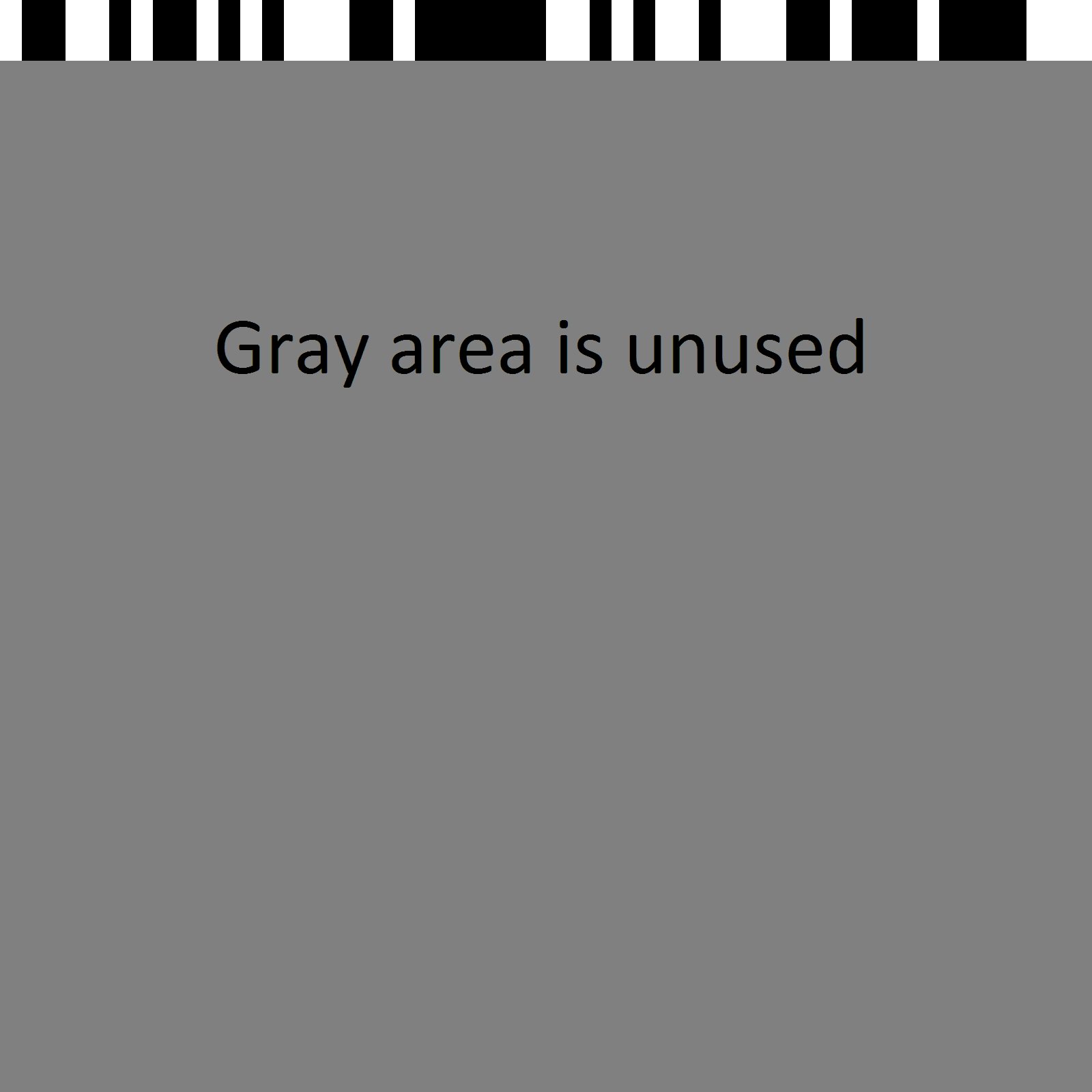

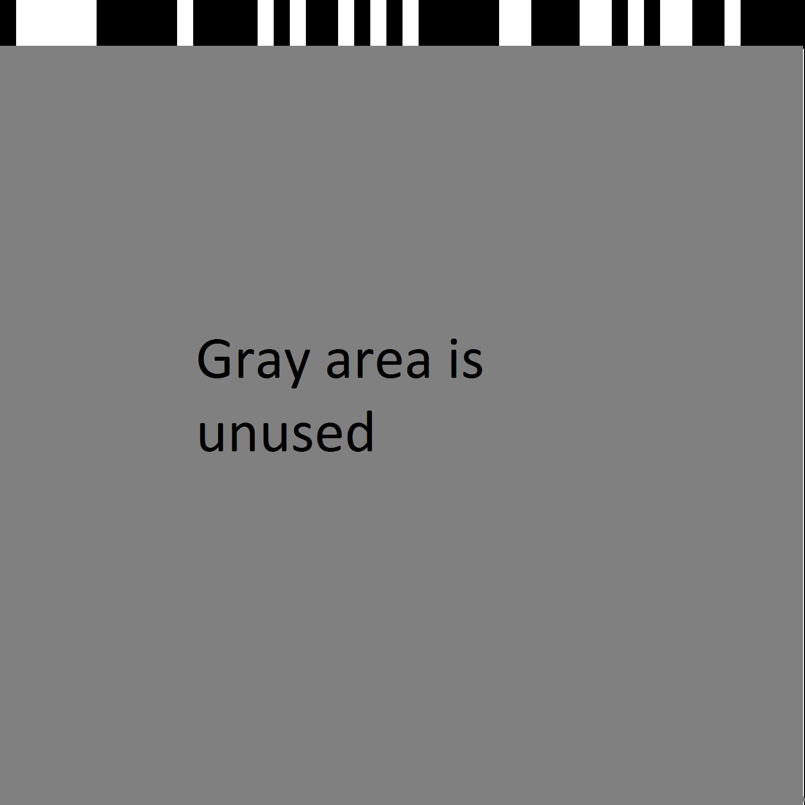

  • Hey Jesus,
    We have the capability to develop on an FPGA using verilog.
    1. The 32x10 blocks don't need to move they are stationary.
    2. there are 50 active squares always, and each switches to a new state that is not predetermined, all the mirrors in a square switch to the same position, all 50 squares should update to the next position at close to the same time. below is an example of what is desired I need to transition from bitmap1 to bitmap2  as fast as possible (pixel count of squares are scaled up).
    3. There will not be light incident on the DMD during a transition period (while the mirrors are switching to new positions).
    Joe
    Here is bitmap1
    Here is bitmap2
  • Hey Joe
    We set Light Crafter 9000 EVM to only use one reset group and the fastest pattern rate was about 44 kHz for fixed patterns. With your application requirement of real time pattern selection, the update rate would be slower.
    Thus the DLP Discovery 4100 EVM with the DLP7000 is the best fit for your applications frame rate and real-time pattern projection.
