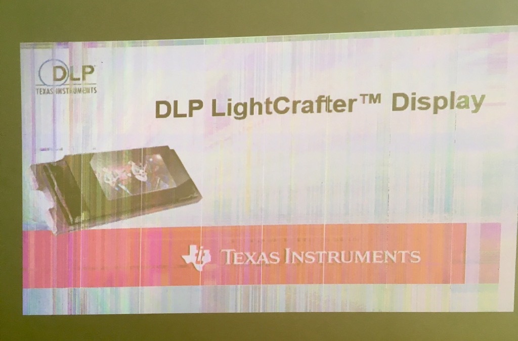

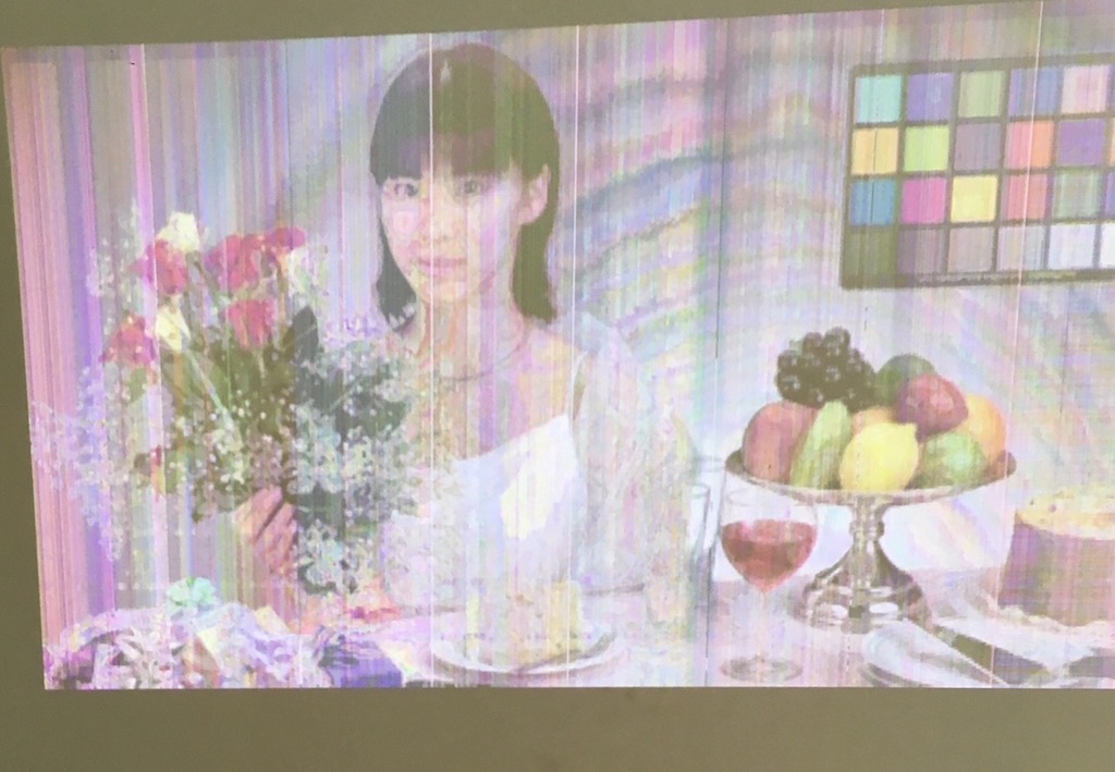

Part Number: DLPDLCR3010EVM
Badly I lent my device; and when it back to me, I turn it on and now the image is horrible.
Can it be repaired or is it just rubbish now? What may be they do to it?
Thank you.
Thanks for using the TI E2E forums. Here are a few things you can try:
1. Reflash the firmware with the standard firmware.
2. If that does not work you can check to flex connection.
Let me know if that helps!
