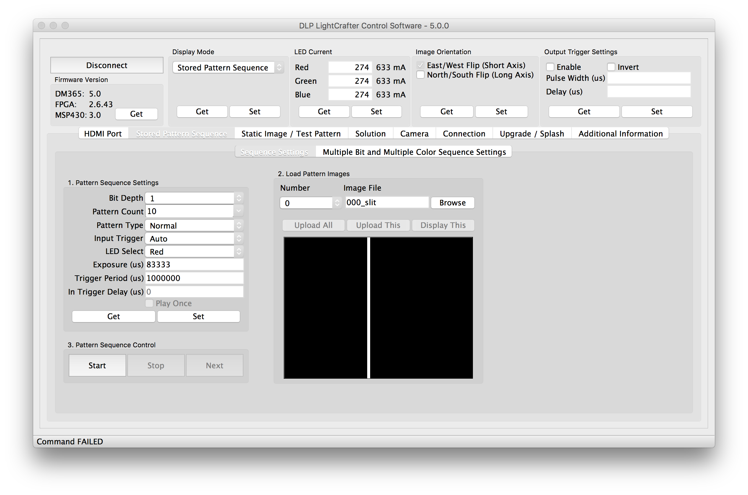

  • Hello.
    1.  Connected power cable and USB cable to EVM
    2. Opened GUI and connected to EVM
    3. Display mode set to Stored Patterned Sequence
    4. Set bit depth, pattern count, exposure, etc
    5. clicked browse and uploaded all 10 images in file selector
    6. Selected Upload All in the GUI --> Command FAILED
    I uploaded 3 images. I could not get this to work with even 1.  It may be better for me to upload them from an SD card, if that is possible

  • The Firmware and Software Bundle 3.0 for mac 12/18/2013 release date
  • Hello Evan,
    Are you able to individually upload the images and get it to work? I'm also curious if you have access to a Windows machine to see if upload all works on that machine. That would help us figure out if the problem is related to the GUI or something else.
