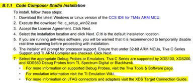

I am trying to debug the Tiva firmware on NIRscan Nano, I notice we need to use XDS emulator connect to the 10PIN JTAG connector.
There are three types mentioned on the GUI (XDS100, XDS200 and XDS560). Could you please give me some suggestions on the emulators we can use?
Thanks.
    Thanks for using the E2E forums! They should all work, but we have seen better performance from the XDS200. If you do have further questions about specifics you could look at the below section of the user's guide or ask the TIva team on their forums.
    Hope that helps!
