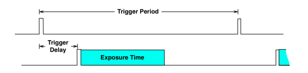

I want to use external trigger to run stored pattern sequence.
What I expect, is to have the pattern ON during given exposure time, then all mirrors in OFF position and then the same with the next pattern with the arrival of next trigger.
Similar to the screenshot from the Lightcrafter user guide, only I don't use delay:
What I get instead though is that the pattern stays ON forever, until the next trigger changes it:

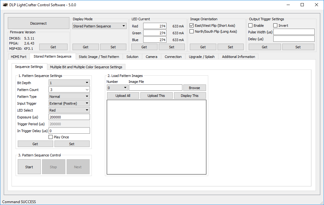

I tried various exposure times, triggers with different duration, duty cycles, and single triggers run manually.
But nothing changes - whatever I do, the pattern seems to ignore the exposure time set.
Here's a screenshot from DLP UI with one of many stored pattern settings that I tried:
Do you know something about this behavour and how could I solve the issue?

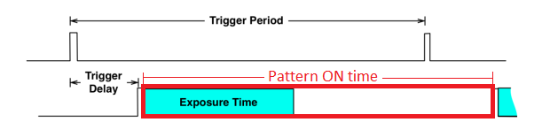

    I will try to reiterate what I want basically to achieve. As in following example screenshot, using external trigger I want to display 3 patterns sequentially, each for 2 seconds. After these 2 sec I need all mirrors to switch to OFF position until the arrival of next trigger and so on.
    What happens though is whatever exposure time I do set, the pattern stays on until the next trigger swiches to next pattern.
    Interestingly, I noticed today that after the exposure time has passed (2 sec in this example), the mirrors emit high-pitch noise until the next trigger arrives, while they are totally silent during the exposure time. I guess that they are static during exposure time and then enter some mirror refresh mode (like video mode).

    I got a response from Keynote Photonics, which explains the issue. In my system I don't use LEDs and the LED module is not installed on my version of Lightcrafter. As they explained, the exposure is controlled not by the DMD, but by LEDs meaning that the pattern stays ON, but the LEDs turn off. That's why in my case there is no exposure time unfortunately.
