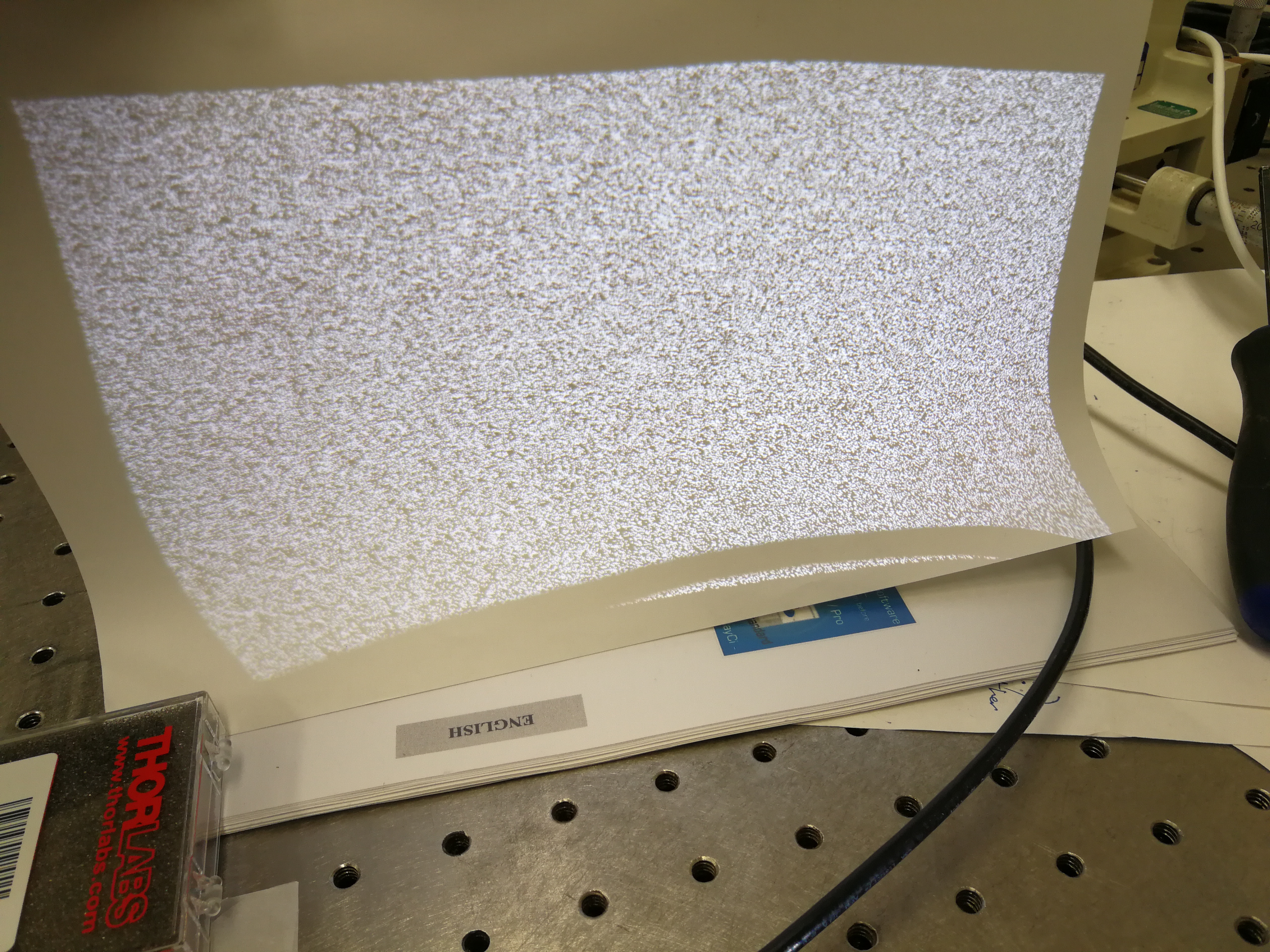

  • After reassembling the Lightcrafter, we can only manage to change the color of the projector output. That is, no test pattern or uploaded .bmp static image changes how the output looks. It appears to me that either the DMD is broken or that the DLPC300 DMD controller cannot communicate with the DMD itself. And here is what the image looks like from the projector:
  • Hello Ethan,
    Unfortunately when you see an image like that it is usually because either the flex cable or DMD itself is broken. Confirm that the flex cable is connected firmly to see if that fixes the problem. If not, unfortunately you would need to obtain a new flex cable and/or DMD.
    Kyle
  • I have checked that the flex cable is firmly connected and I'm still seeing the same thing, so I'm assuming something is broken. Given the behavior that I've observed, is it likely that the circuit boards are functioning properly and that replacing the DLP3000 would fix the issue? Or do you think the circuit boards are faulty as well?
  • Obviously it's difficult to be 100% sure but usually when I see a pattern like that it is because there is an issue with the DMD. It could be verified by using another light engine and seeing if it can be driven by the same PCB.
    Kyle
  • Hi Ethan,
    when making your setup, did you by any chance remove the DMD and put it back into its socket?
    I did it once and have put the DMD DLP3000 upside down by mistake. After that I got similar symptoms, luckily nothing was damaged and when I corrected the polarity of DMD chip, everything worked fine.
    Karl
  • Thanks for the tip Karl, that sounds worth checking.
    And I should have emphasized before that you can also check with another flex cable before replacing the DMD to see if that's the issue.
