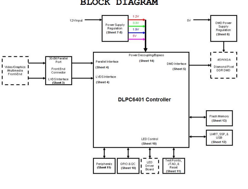

1) There's a reference design for a PCB utilizing the DLPC6501 and the corresponding LED controller here www.ti.com/.../toolssoftware ,
however I can't find info whether the design without modification supports 120Hz WXGA stereoscopic video input.
3) Also, info on how much current can be supplied to the LEDs with this reference design board would be nice, some optical engine manufacturers use LEDs with as much as 20W power.
4) Finally, can the reference design PCB accept 1080p @ 120 Hz input and downscale to 1280x800 @ 120 Hz?

The TI design you reference is not really an evaluation module. It is more like a design recommendation. does not specify a led driver set up or optics. Also there is not video processing front end so it would be required be done externally with video input be in 30-bit parallel. (See Below)

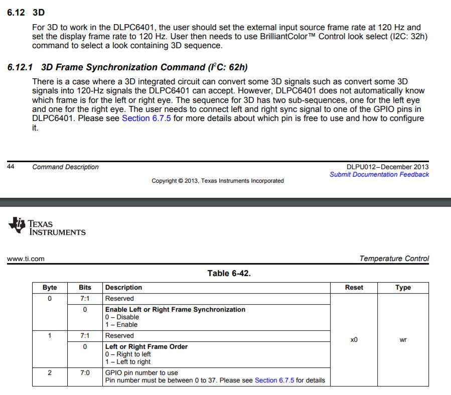

I understand now. I will look into some of our design partners to see if any have a solution for your situation. I did find in the dlpc6401 programmer's guide a section pertaining to 3D. It looks like you design will require a special IC that will convert 3D video to something usable by the DLPC6401. It will also require some configuring some setting of the DLPC6401. See below.
