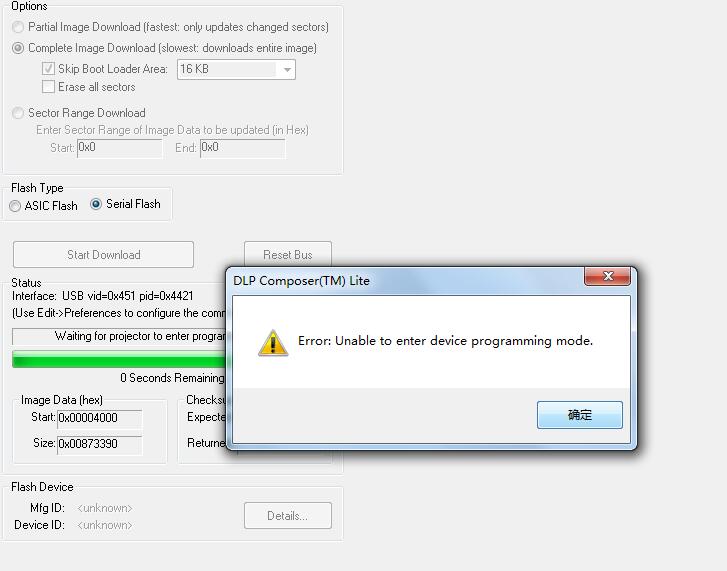

I am developing a 4K projector with DLP660TE.
Now I have completed PCB board and debugging main board.
But I can not download the image to FPGA by composer lite, and it occurs USB error, please see the pictures.
Before welding, I have download the DDP4422 image by programming tool, and I can get running information by UART.
Perhaps I have not get the serial flash information or USB not reset.
If some details wrong, please guide me.
Thanks for any help.
  • [BEGIN] 2017-12-08 11:22:20
    Debug opened on URT0
    EEPROM content is valid
    EEPROM: Initializing Slave EEPROM: 3320 bytes
    sysmon: System Startup State From AppCfg is 0
    sysmon: Notify uC ASIC is running.
    sysmon: 1.8V power enabled via PMD
    Serial Flash NVM = 0xEFCF
    sysmon: Low-power mode change cc = 1
    sysmon: Memory test cc = 1
    sysmon: System mailbox ID = f7ff44f4
    API version: 07.00.00
    App version: 07.00.00
    ASIC ID: 50
    ASIC Configuration: 4422
    Configuration layout versions:
         Seq Map: 44.21.0019
         SW Map: 44.21.0000
         EEPROM: 07.00.0000
    *****Through DDP_Init cw & seq*****
    projectorCtl: Opening projector control on USB

    DMD FUSE ID VALIDATED
    illumination: DMD comm error in DMD_Power()
    source: EEPROM defined
    source: SetUserSFGColor = 0
    source: DisplaySFG Color = 0
    source: DisplaySFG size = 1358 x 1528
    pictcont: color profile defaults written to EEPROM
    illumination: Can't set up DMD
    sysmon: Fault in illumination transition to operating mode
    sysmon: Sysmon can't transition to operating mode

    datapathf: datapath_ConfigFPGAatStartup
    FPGA Write Unsuccessful, returned 249

  • Hello Kelly,
    Thanks for using the DLP forums! Someone will get in contact with you through a private message to further discuss this issue.
    -Oscar
  • Hi, Oscar
    Thank you for your reply.
    I can download image today, and DLPC and FPGA boot OK.
    But DMD is no response and no projection.
    I have read boot information by UART maseter, but not sure the problem why.
    The UART read log is this.

    My DMD part NO is 2715-7039P.
    Can we discuss this problem through a private message?
