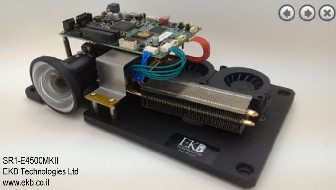

We are looking for a wide angle short throw platform for our depth measurement setup that we are currently working on. We are considering purchasing the LightCrafter 4500. Is there any lens selection option with LightCrafter4500 for producing wide angle? We need to produce an image width of 50cm at about 20cm distance.
  • Dear Jörg Schulz
    EKB Technologies Offers SR1-E4500 MKII Platform. The SR1 delivers a short throw ratio of 0.6. The standard LightCrafter4500 delivers a throw ratio of 1.2.
    This means you'd be able to produce an image size of 50cm in width and 31cm at height at a distance of 30cm. (Would that work for you?)
    Do you plan to work in the visible spectrum or NIR? We also offer extended depth of focus laser based SR1 in IR.
    You can find additional information on our eStore at www..ekb.co.il
  • This looks good, thank you. For the time being we are interested in RGB for the prototype but our plan is to eventually work in IR in the final assembly.
