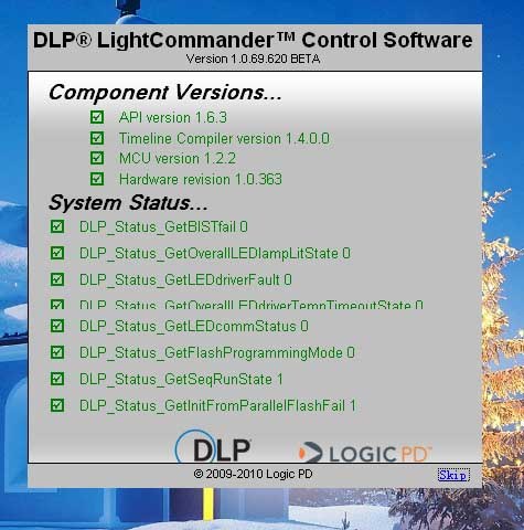

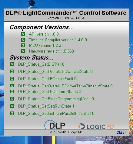

           I did the same thing as Peter has done. The Kit still didn't work. I remembered that the report of sofware is like
    at the first time it run.    The report changes to
    after I pressed the "Program Flash" button on the menu.  Now, the report changed back to the first status after I excuted the command "$L2.5 DLP_FlashProgram_EraseParallelFlash 0, 128". I guess it maybe probles of controller. The voltage level of DLPA200 and LED SPI interface are very diferent from the reference.
