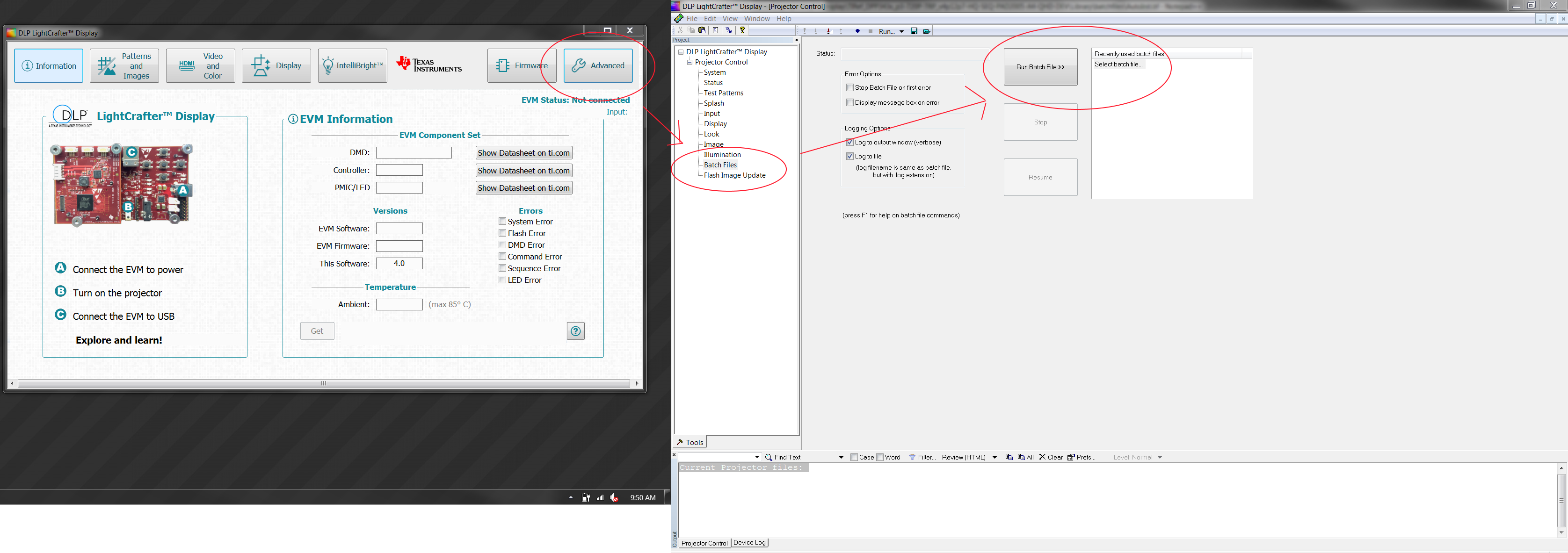

I'm working with dlp3010 and GUI program
I want to change firmware's splash image automatically (i have already uploaded firmware to dlp3010)
(ex) display splash image1 -> wait 1ms -> display splash image2 -> wait 1ms -> display splash image3 -> wait 1ms -> display splash image4
I think using "Batch File" is a solution, but l don't know how to do that
"user guide for dlp lightcrafter display.pdf" doesn't have enough about batch file. that just have short sample
so help Me!!

    To be sure, are you referring to the EVM GUI tool User's guide? It can be found here:
    http://www.ti.com/lit/ug/dlpu021b/dlpu021b.pdf
    The batch file example in Section 5 has most of the information you need to create your own batch files. In addition, I recommend you review the DLPC343x programmers guide for a list of I2C commands to help you create your batch files:
    http://www.ti.com/lit/ug/dlpu020a/dlpu020a.pdf
    Once you have a batch file ready, you should take it to the "Batch File" window whose location is shown in the image below in DLP LightCrafter Display GUI software. select and execute your batch file as shown to test it.
