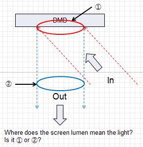

  • Fizix-san,
    Thank you for your support always.
    I got the additional questions about the screen lumen from customer.
    Where does the screen lumen mean the light?
    ①:Light on the DMD
    ②:Light exiting the DMD
    Best Regards,
    Leonardo
  • Hello Leonardo,
    The answer is #2 (sort of).  Typically it is actually measured at the screen in several points (average luminous flux [ illuminance ] coming to the screen x the area).
    Let's use an example for a given projector:
    • Suppose a screen is at 5 m and has an average luminous flux of say 200 lm/m^2 and a projected area of 5 m^2..  Then the total output from the projector is 200 lm/m^2 x 5 m^2  which gives 1000 lumens.
    • Now suppowe we move the screen out to 10 m distance.  Since the distance is doubled, both the x & y dimension of the screen are doubled so that the area is quadrupled (4 x).  The projected area is now 20 m^2.  But the light is also spread out by the same factor and the average luminous flux goes down by a factor of 4 to 50 lm/m^2.  Then the total output is 50 lm/m^2 x 20 m^2 which again gives 1000 lumens.
    I hope that helps.
    Fizix
