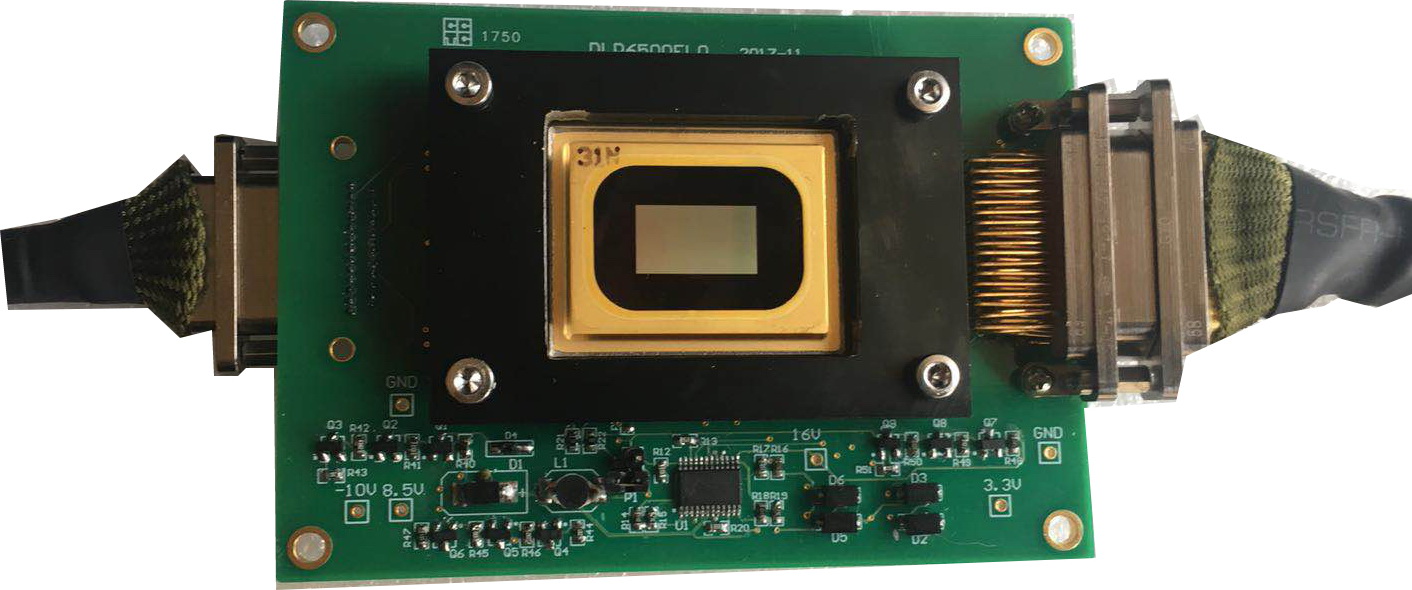

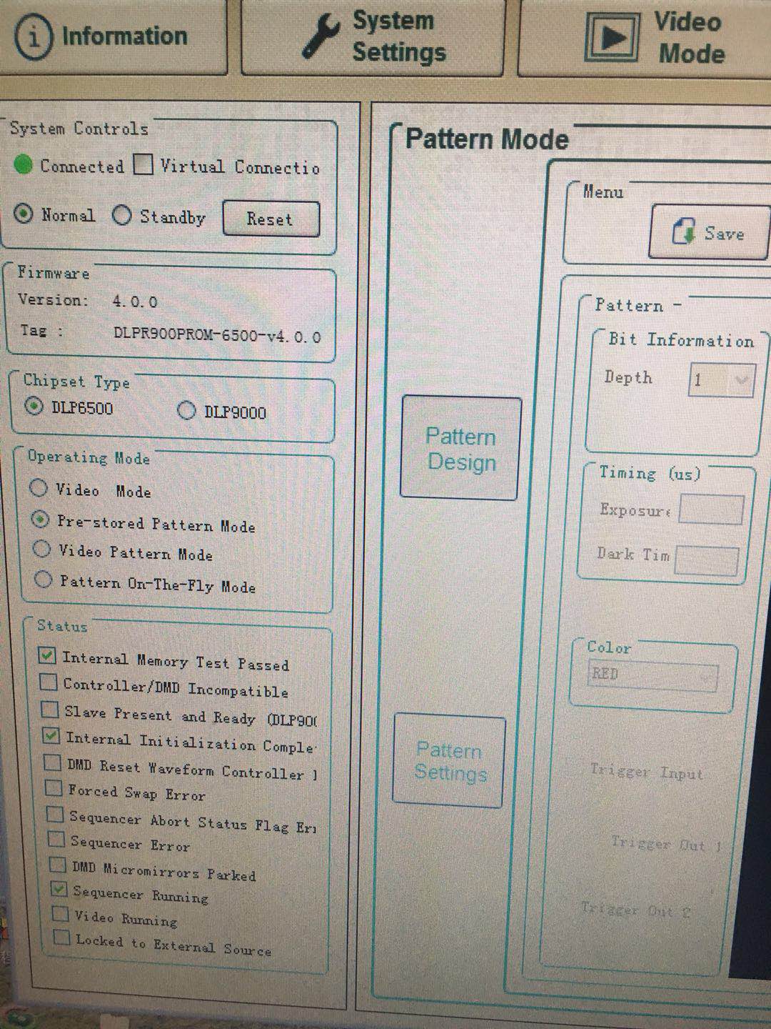

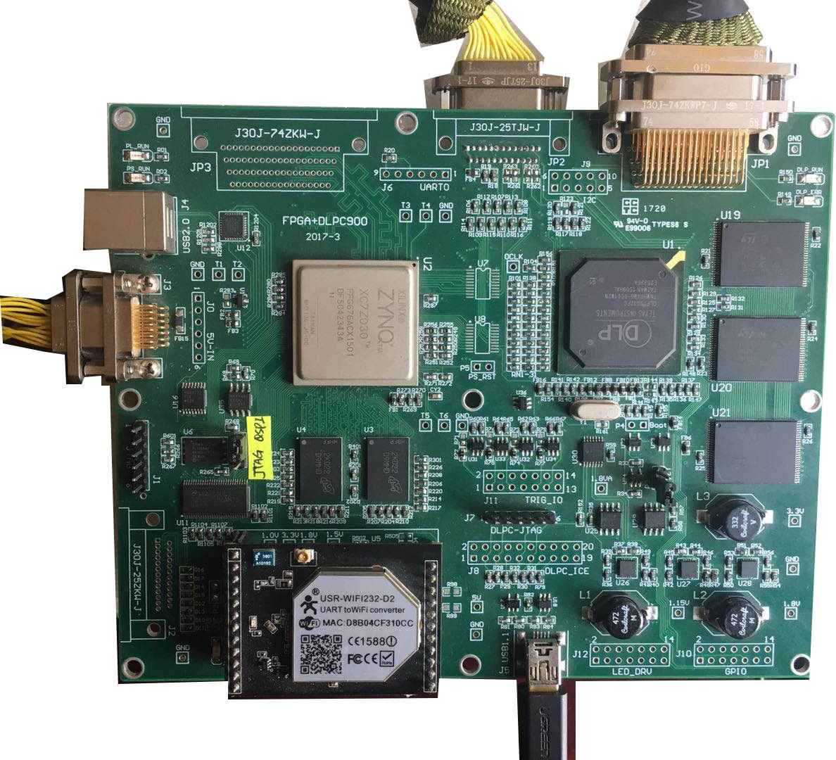

We designed a custom DLP application system with reference to 6500EVM without IT6535.The hardwae all seem to work well, only the "Internal Memory Test Passed" of status is not checked!,and any pre-stored images in the flash  are not display on the DMD.When we click on "Update LUT" in Pattern On-The-Fly Mode ,a box of Error:Sending Pattern LUT size failed! pop up after some seconds,then LED(D6) stop blink and the GUI stop!

  • Hello Fizix, Thanks for your reply.
    We use three chips of parallel flash same as EVM,I think all flash work well,because update and boot firmware all OK.
    We use "Pattern On-The-Fly mode" only for test by USB,because no images are displayed on DMD in "Pre-stored pattern mode"(pre-stored pattern) and " Video mode"(test pattern)
    In our system ,no DDR memory be used! and the EVM also didnot! Which chips are DDR memory in 6500EVM?

  • Thanks Fizix!
    I have sloved the issue! 1.8V for the internal DRAM of DLPC900 is bad!(only 0.8V!).
    Now "Internal Memory Test Passed" is checked!, But also no images are displayed on DMD! When power up,the operation mode of the GUI allways is "pre-stored pattern mode".
    If we change it  to other   mode(i.e. "Pattern On-The-Fly  mode"),the LED(D6) will stop blink,and GUI also stop!

    If you have no D_CLKS, there is something very wrong. Make sure your scope is fast enough to see the 400 MHz D_CLK. It seems to recognize the part (from your GUI screenshot), but is not sending data/clocks.

    Something is definitely wrong in or around the DMD. Do you have a DLP6500FLQ DMD that you can try?
    Something is telling the regulator to disable the voltages.
    Can you check the RESET_IRQZ pin coming from the DMD to the DLPC900 (pin Z5 on the DMD). It should be at some point be asserted letting the controller know to query the DMD. You will need to use a scope to potentially capture the event (signal going low).
