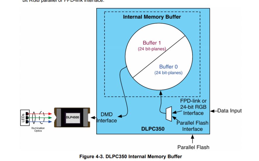

I am using the DLP4500 in conjunction with the DLPC350 for a structured light application. Due to the 48-bit plane limitation in RAM, I am forced to pause the processing when the 48-bit planes have been displayed, load the the next ones, and continue, which of course incurs a delay in the processing.
My question is, is there a way to work around this limitation?
Otherwise is it possible to have the DLP350 firmware source code so that we can implement our own processing to generate patterns on the fly?
