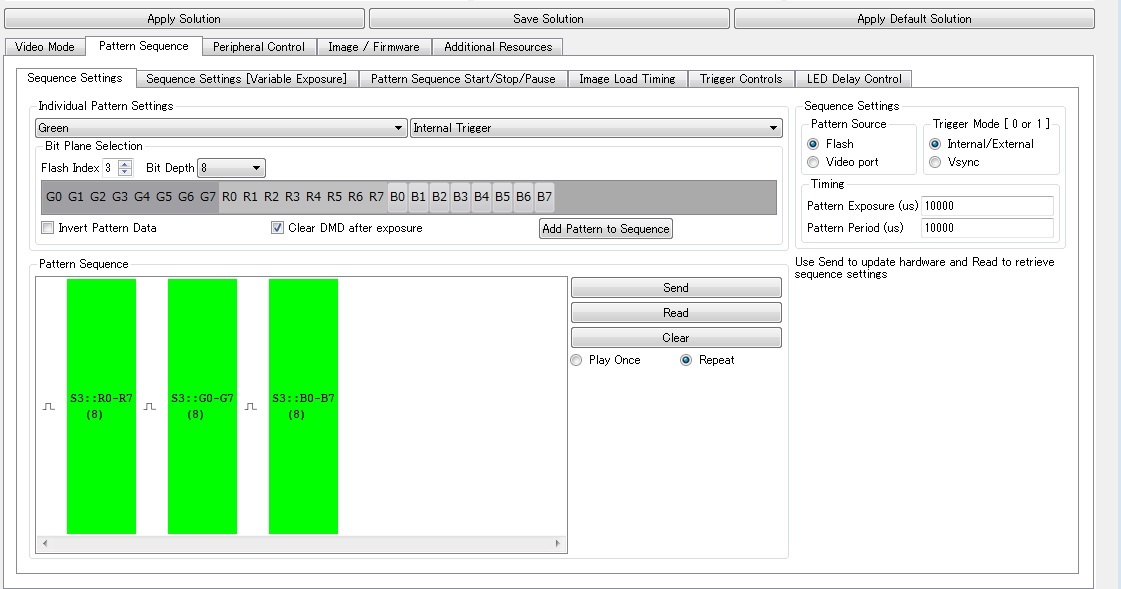

I made a test picture which is gradation from white(0xffff) to black(0x0000). And, this source file newly stored in flash.
And this picture was displayed by pattern sequence 8bit depth. The displayed result looks like something of border as shown below. Please let me know the cause root or what was happened.

    My test picture's bmp is recreated as below.(8bit [R7 R6...R0] → Add to Output File, 8bit [G7 G6...G0]→ Add to Output File, 8bit [B7 B6...B0]→ Add to Output File) I also attach the bmp and bin which is embedded as #3 flash.
    Pattern sequence settings are as follows.
    Flash Index 3 / 8bit R : Add pattern sequence → 8bit G : Add pattern sequence → 8bit B : Add pattern sequence

  • Hi Uryyy,
    If you are seeing the flickering naked eyes, this is expected, note the content displayed in pattern sequence is different from video mode. The video sequences are optimized for reducing the flickering artifact and at the same time they are not 100% pixel accurate. In case of pattern sequence they are pixel accurate and intended for structured/machine vision kind of system application. As an example - Video sequence displaying WXGA 1280x800 24bpp @ 120Hz where as if you apply pixel accurate, to display 8-bit gray scale input it requires almost same time 8.3ms, in video mode we display 24bit RGB888 in same 8.3ms window.
