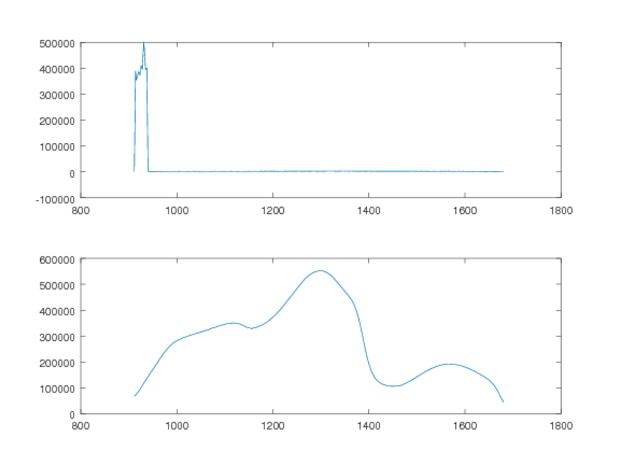

I'm trying to write a Linux library to control the spectrometer over USB.
Everything is working fine on the communication side, as I ported the API part from the GUI and using HIDAPI. For interpretation I'm using the Spectrum Library.
But when I'm trying to use this code I get either a normal spectrum as expected (pic bottom), or something weird (pic top):

    Please let me ask for clarification. Does this behavior occur over repeated scans of the same sample, or over different samples? In addition, please share whatever test setup conditions you have (e.g. how many systems/samples have you tested, repeatability, etc.).
    Philippe Dollo
  • Hi Philippe, thank you for the fast reply!
    The situation is like follows:
    When using the GUI in a virtual machine in windows, the results of the scan are perfectly fine, On every scan I make.
    When using my library in linux to do a scan, everything is also working fine, the scan data blob gets interpreted without error and the struct is valid, the wavelengths are the right one, only the values for intensity are weird:
    The first few values are: 27902, 17353236, 18569717, 19937013, 21225973, 22510325, 23654133, 24756725, 25682421, 26928373, 27800565, 28766197, 77813, 82738, 86145, 89917, 93654, 97983, 101878, ...
    My test setup is: I'm putting leaves on aluminium sheet as background and putting this onto the window. Iv'e tested 20-30 samples with one device, the problem for shure is not about the test setup, because it doesn't happen with the GUI. It's most probably something in my code, maybe timings, maybe I've missed some command, etc...

        uScanData *scanDat = (uScanData *)scanDatBlob;
        // fetchActiveConfig();
        if (runScan() != PASS)
            return FAIL;
        int realFileSize = fetchScan(scanDatBlob);
        scanResults results;
        scanResults refResults;
        dlpspec_scan_interpret(scanDatBlob, realFileSize, &results);
        dlpspec_scan_interpReference(refCalDataBlob, SCAN_DATA_BLOB_SIZE,
                                     refCalMatrixBlob, REF_CAL_MATRIX_BLOB_SIZE,
                                     &results, &refResults);
        dlpspec_scan_read_data(scanDatBlob, realFileSize);
        spectrum.dataSize = results.length;
        for (size_t i = 0; i < results.length; i++)
            spectrum.wavelength[i] = refResults.wavelength[i];
            spectrum.reference[i] = refResults.intensity[i];
            spectrum.intensity[i] = results.intensity[i];
        spectrum.startWavelength = results.cfg.section[0].wavelength_start_nm;
        spectrum.endWavelength = results.cfg.section[0].wavelength_end_nm;
        spectrum.repeats = results.cfg.head.num_repeats;
        spectrum.exposureTime = results.cfg.section[0].exposure_time;
        spectrum.resolution = results.cfg.section[0].width_px;
        spectrum.gain = scanDat->slew_data.pga;
        spectrum.detectorTemperature = scanDat->slew_data.detector_temp_hundredths / 100.0;
        spectrum.systemTemperature = scanDat->slew_data.system_temp_hundredths / 100.0;
        spectrum.relHumidity = scanDat->slew_data.humidity_hundredths / 100.0;
        spectrum.lampIntensity = scanDat->slew_data.lamp_pd;
        uint32 pVal;
        NNO_error_status_struct error_status;
        NNO_ReadDeviceStatus(&pVal);
        NNO_ReadErrorStatus(&error_status);
        cout << "Device status: " << pVal << endl
             << "Error status: " << error_status.status << endl
             << "Error code adc: " << (int)error_status.errorCodes.adc << endl
             << "Error code eeprom: " << (int)error_status.errorCodes.eeprom << endl
             << "Error code hdc: " << (int)error_status.errorCodes.hdc << endl
             << "Error code hw: " << (int)error_status.errorCodes.hw << endl
             << "Error code spec_lib: " << (int)error_status.errorCodes.spec_lib << endl
             << "Error code scan: " << (int)error_status.errorCodes.scan << endl
             << "Error code tmp: " << (int)error_status.errorCodes.tmp << endl
             << "Error code memory: " << (int)error_status.errorCodes.memory << endl;
        return PASS;

    Harry
  • So I tried around a lot, and it seems to be my desktop system itself, on a Raspberry Pi (which will be the host system anyways) it's running without problems...
    I'll try it tomorrow with my PC at the office and give a report, if this error is not reproducible, then I guess this thread can be closed.
    EDIT: So checked it on several other systems, and everything is fine, so this can be closed.
